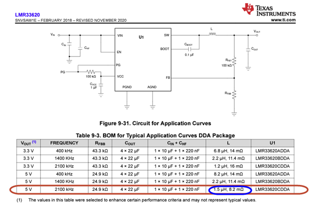

LMR33620: TI suggested part number for the output inductor "L" in a 5V/2A setup
Part Number: LMR33620
Hi support team,
We are designing our 5V/2A power supply using the LMR33620CDDA switching regulator and we would like to know if TI has a suggested part number for the inductor "L" (1.5uH, 8.2mOhm) in the following diagram that we found in the datasheet:
