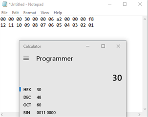

My questions regarding TPS65988 bootflagss (0x2D) register in this below.
  1. I read the boott 0x2D the value is f8000000a206000030000000, then swap 00000030000006a2000000f8 , is it need to be swap ?
  2. Based on the above values, could you confirm if the valure read is correct ?
    1. the Bits 3 (bytes 1~4) like the SpiFlashPresent is it the value is 1 is it right ?
    2. the Bit 4 ~7 Region 0 ~ 1, Region 1Invalid ~ Region0Invalid is 1 is it right ?
    3. the Bits (bytes 9~12) like the REV_ID Metal is it the value is 2 ?
    4. the Bits (byte 9~12) like the REV_ID Base is it the value is A ?
    5. In the TPS65988 TRM datasheet the REV_ID metal and REV_ID Base in the bytes 9 ~12, but why in the value read was in the bits 32 ~ 39 ?

  • Hi Sofian,
    [1]
    Yes, your "swap" is correct. We return the lowest word first.
    You can reference this figure for bit order.
    [2]
    It looks like bytes 5-8 are hidden and likely reserved. Byte 9, which corresponds to the metal_rev and base from your read is 30, so it would be revision 0, and rev_id base is 3.
    Thanks and Regards,
    Chris
