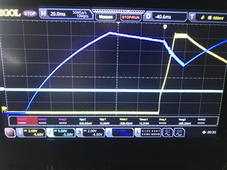

we have a design based on PMP20742 which shows a problem with the output voltage. The voltage drops, it looks like the UCC2897A goes into standby/disabled mode when this happens. The reference voltage Vref drops to zero in this case (this is seen approx. once in a second), but sometimes it also stays high.
I attached a photo from the scope, yellow is Vout, blue is Vfb, purple is Vbias
As Vbias drops belov 8V I assume, that this could be the reason for the controller to go in a disabled mode or restart. I already tried to increase the bias capacitor without success.

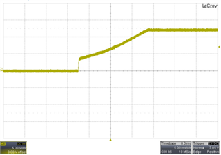

    Initial startup of the PMP20742 looks like the following.  How does the initial startup of your design look?

  • The schematic is basically the same as the PMP20742 with some output regulators added for multiple voltages. The parts are the same except for the MLCC where some of the parts were not available. They are replaced by caps with same capacitances.
    Here you can see the startup of the design. Vout in yellow, Vbias in blue.
