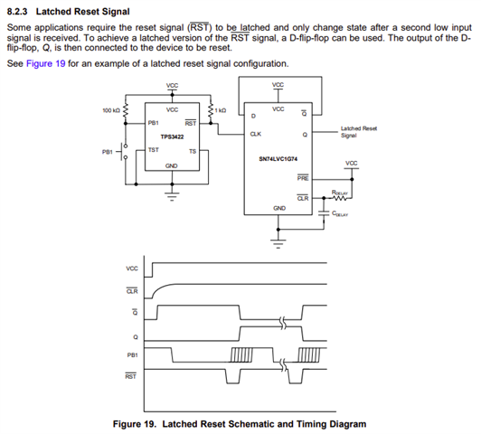

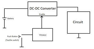

Hi, I am planning to use TPS3422 in following design. My application is to enable DC-DC converter after pressing and holding tactile switch, and turning it off after pressing and holding same switch again. My question is that I could not find any application of TPS3422 where it can keep DC-DC converter on for desired period of time. Is there any other IC, I can use for this purpose?
