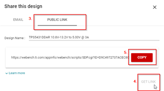

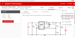

    Currently , We don't have explicit option to copy or create duplicate of the webench design. However, you can use below steps to create two designs.
    1.Create a first WBENCH design.
    2. Click on three dots at right top corner and click on ' Share Design'
    3. Click on 'PUBLIC LINK' and then click on GET LINK. Once link is generated , copy the link.
    4. Now open the link in new tab of the browser. This will be copy of your first design.
    Kindly let us know if you have any queries.
