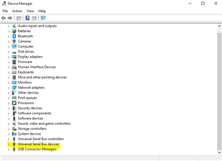

 There're certification issue about TBT4 docking at my customer side (GODZILLA platform, using TPS65988DK,GUI v6.3.4). In lab TCM test, there will have yellow mark at device manager:
 Do you have experience about the issue at your customer side? And any idea for debug the issue? Intel don't accept to waive it if we don't have idea about that. Thanks for your kindly help.

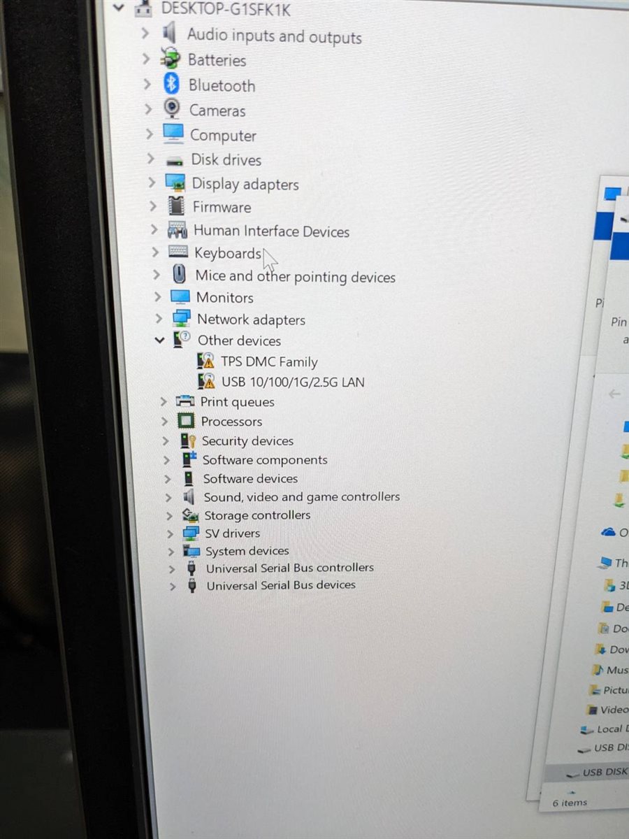

    Here are a couple things to check to identify the issue (when it fails)
    1. Open device manager and check to see if the 982DMC(TPS DMC Family) appears under USB devices
    2. If the 982DMC device is there, right click on the device and open properties. Can you get screenshots of:
      1. The General Tab
      2. Under the details tab
        1. Device description
        2. Hardware IDs
    3. What version of the base firmware is on the tps65982DMC device?

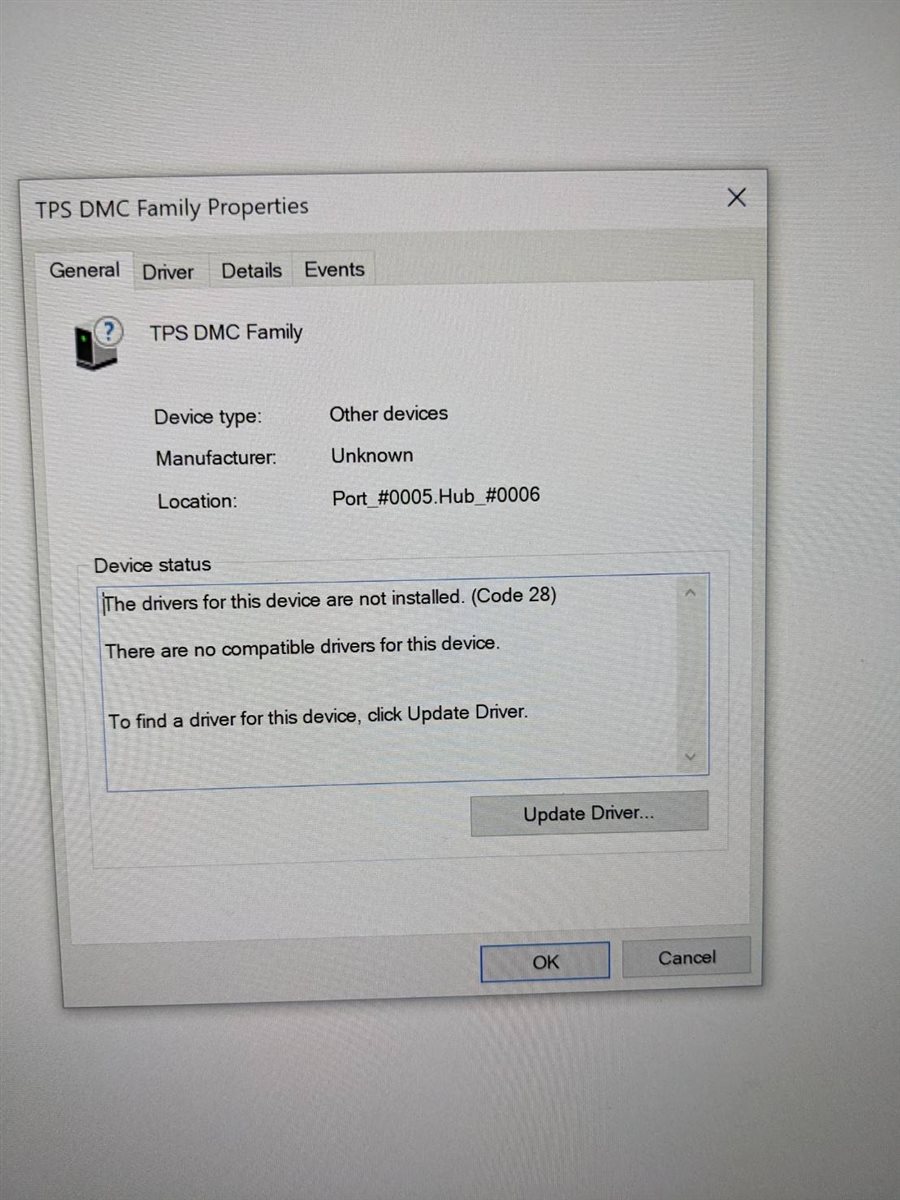

  • Hi Chris,
     1. Test equipment is Win10 Version 20H2 (OS Build 19042.1706)
     2. They can't see 982DMC device in device manager if there's no code 28 issue.
     3. Please check the screen shot at failed condition.
    4. DMC version is DMC_E0001_50_08
    5. I just see new GUI on secure website. I'll check that and let customer test it if there's newer DMC FW.
    Gary
  • Hi Gary,
    2/50 means it is failing 2/50 times? It works correctly the other 48?
    Have they moved off of Win11?
    If the device is not visible, doesn't that mean the the device is not connecting at all? Wouldn't the optimal case be for the 982DMC to appear in the devices tab but without the "yellow bang".  Please have them check  the USB Devices tab when there is no code 28 issue.
    The screen shot looks correct. It appears to have the correct TI VID and device.
    Can you also send:
    1. From Properties
      1. an image of the "Device Description" tab within Details
      2. an image of the "General" tab
    2. an image of the "Universal Serial Bus Devices" in the device manager
    Also, is the 982DMC appearing in the USB devices tab?

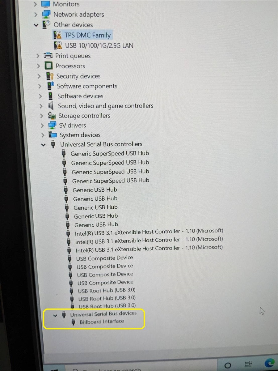

    Here is Arrow FAE Jeff help Gary capture some figure when issue happended.
    Update below information.
    1. From Properties
    B. an image of the "General" tab
    Thanks!
    Jeff

  • Hi Gary,
    Sorry for the delays.
    I was looking over this thread with a senior engineer and there are other concerns we had with some of the comments made.
    Does this test ever pass?
    My current understanding is you are using the "Yellow Bang" to determine that the test has failed. When the test "passes", they do not see the device. If the device is connecting properly, you should see it in device manager.
    When the device connects properly, you should see it appear without a yellow bang in the Universal serial bus devices dropdown.
    This is my current windows version.
    Did the customer try the ZaDig tool we mentioned previously? This way we could force the driver for the port and see if the device connects. This would help us determine what the issue might be.
    We did not do 100x test, but we did test it ~20x and saw no failures.
    Or, if you can provide comment to describe the issue and that's not relatived with TI or TI can solve it but need time, maybe Intel can accept to waive the issue?
    We are not sure what the issue is. It could potentially be TI or Windows. We think it is mainly related to the drivers but there are couple things that may affect this.
