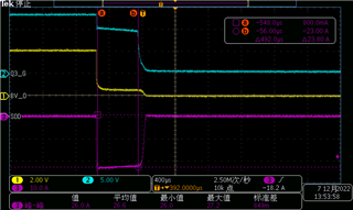

We are using BQ78Z100 on a single cell battery. The OCD is set to 2.6V, 2s. During the verification test, the delay is tested as 3.8s when 2.6A applied, and 3.5s when 2.7A applied. So could you help to check the reason of this big tolerance on the delay?
Also the ASCD shows a longer delay. It was set at 22.2A with 244us delay, but tested as ~500us as shown below. The blue line is the MOSFET gate signal, and yellow is the output voltage, and purple is the current.
So is this normal to have this delay tolerance for this IC?
Thank you!
