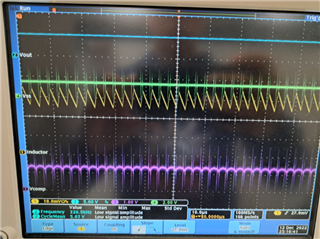

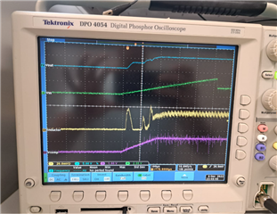

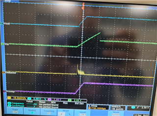

Hi, I designed a DC/DC converter using a LM25116 and everything is fine. I measure the Frequency and it is 336Khz, Vout 5.1V @Iout 6A; however, checking the transient response, Vout is not a straight "ramp" as the DS but it more like different steps. is this might be bad soldering? Because I solder everything by myself
 PS: The first measurement was ok as the picture below, but when I change the Iout from 6A to 4A, the Vout started behaving like the above picture in all Iout (1A, 2A,4A, 6A).

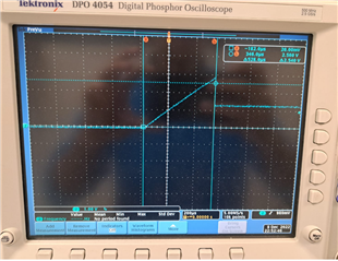

  • The load is DC (I'm using a DC Electronic series)
    V(SS-AGND) Look smooth.

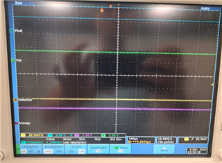

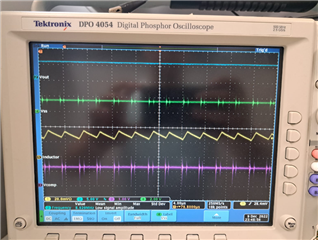

  • Hi Eric, sorry for the delay. So here are the waveforms
    This is without Load (Vout 5V1 and Iout 0A)
    And this is with a resistance load Iout 6A
    So I see some noise in the Vcomp and Vss with maximum load. However, the output waveform during the start-up is almost the same than it is load

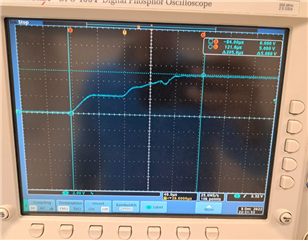

  • Hi Eric. So checking what you said, I noticed a mistake on my circuit. I put in the Css 1.8nF capacitor instead of 18nF, giving the former a soft-start of 210uS.
    I changed the capacitor to 20nF since I don't have right now 18nF ceramic capacitor (I need to wait few days to get it from DIgikey) and the output is smoothly. Additionally I need to change Chf (loop compensation) because I made the same mistake as in Css and I put a 1.8nF capacitor instead of 18nF (in this time I replace it for a 10nF capacitor).

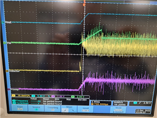

    Now my question is, the soft-start is fine but there is some noise in the SS and Comp pin
    Without Load
    Full load (Iout 6A)
    why does it show a lot of noise in Vcomp and Vss? I might made a mistake because I measure the signal with GND (Vout) instead of AGND.
  • Hello Andres
    I think you are talking about switching noise. You will be able to see  better waveforms if you measure COMP-AGND and SS-AGND at the device pin using a probe with short ground lead
