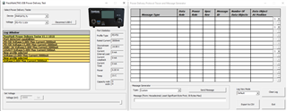

  • Hi Tobias,
    Can you capture a PD log when switching the sink PDOs? It might be a PM125 limit with not being able to send new sink cap when switching sink PDOs.
    Thanks and Regards,
    Raymond Lin

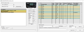

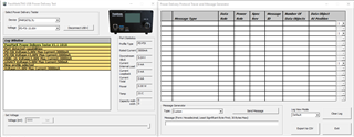

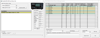

  • Hi. Absolutely.
    Switching from (default) 15V/3A PDO to 5V/3A PDO:
    Switching from (default) 5V/3A PDO to 15V/3A PDO:
    As you can see, no negotiation happens between the Sink/Source - no change in voltage. But the CC lines "must" be fine as the negotitation/Source Capabilities on initial plug-in works just fine (as seen in the earlier PD-logs and the fact that the correct PDO's are listed in the PM125).

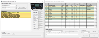

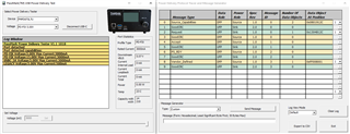

    However, when trying the same thing on the TPS65988EVM, I get:
    (Default) 5V/3A to 15V/3A:
    And back to 5V/3A (including the negotiation for 15V/3A still in the log):
    This is what leads me to believe that the PM125 "should" be able to send sink cap.
    Any ideas?
    Tobias

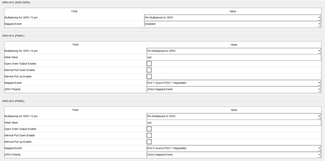

  • Hello again, I manages to solve the specific issue.
    The issue was with me writing the data the wrong way to the PD 3.0 Configuration Register (0x42) (i.e. [0x00, 0x00, 0x04, 0x1A] instead of [0x1A, 0x04, 0x00, 0x00]).

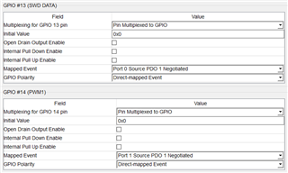

    However, the configuration only works for one port. The port it does not work for tries to use the GPIO #13 (SWD DATA) for toggling between 5 and 15 V from a variable DCDC output, but "it never goes high/3V3. Are there any limitations to using GPIO #13 for this? I believe it is what is used in the EVM default configuration.
    GPIO #14 is used for the other port (in the same way) and works as intended with the current configuration.
    Thanks!
    // Tobias
  • Hi Tobias,
    There should not be any limitations with GPIO 13. It should work the same as GPIO 14 but for th eother port.
    Thanks and Regards,
    Chris
  • Hi again, thank you for your time.
    After patching with jumper wires/reconfiguring to GPIO15 instead of 13 - the "Port 0 Source PDO 1 Negotiated" goes high as expected and wanted functionality is achieved.
    However, as a last question - since I've tried the "old configuration" (see images in lmy last reply) with GPIO13 on multiple manufactured units (even checked soldering/resoldered GPIO13/Pin 41), with no success. You are sure that for the TPS65988 there are nothing "special" needed to set GPIO13 as output/be used as described above - since it is labeled as "SWD DATA" etc?
  • Hi Tobias,
    I was able to talk with the engineer that supports the GUI and he said that the (SWD DATA) should not be there. The datasheet also makes no reference of that pin being SWD DATA.
    That pin should function as a normal GPIO, but let me see if I can replicate your issue on my end with a 65988EVM.
    If you have the even working with GPIO15, I recommend continuing to use that GPIO.
    Thanks and Regards,
    Chris.
