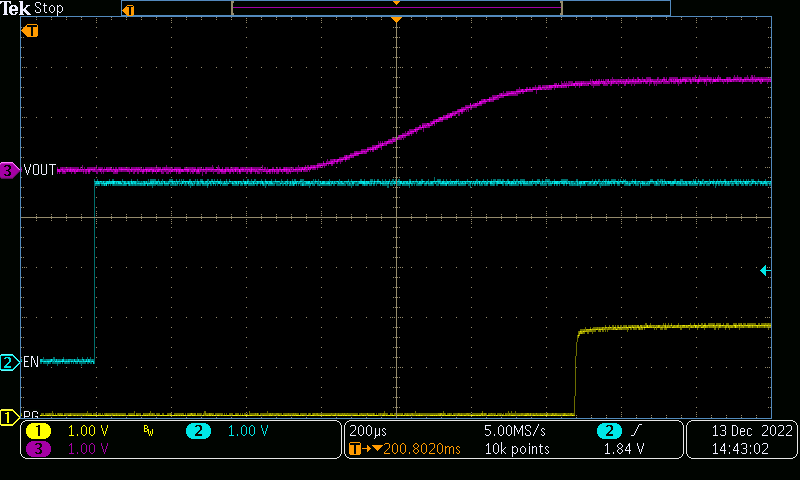

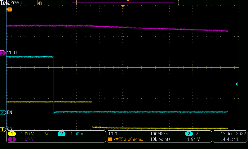

  • Here are 2 plots for reference.  One enable, and one disable.  Plots include Vout, EN, and PG.
    This is with a stock EVM and 1.5A load.   Cout is 226.6uF
    Hopefully this gives you enough data to calculate your supply timing.
    Wade
  • Thanks Wade.
    So for the power down picture, I am seeing
    1) EN goes low
    2) Approx. 16us later, PG goes low based off Vout being 86% or lower of Vout (so around 1.55V)?
    If that is so, it is hard to tell when Vout drops that low, but if my assumptions are correct, it looks like PG goes low pretty quickly after this for the setup you have.
    Does this all seem reasonable?
  • Matty,
    yes, I agree with your assessment.
    Keep in mind the PG threshold of 86% is worst case. Typical is 90%.    I should have changed the vertical scale for Vout, so it would be a little easier to see its drop relative to PG de-assertion.
    It might be better to think about this as the LDO stops passing current ~10-20uS after EN goes low.
    You should be able to estimate how fast Vout decays with your capacitance and load and keep enough margin to insure your sequence is correct.
