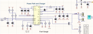

Please can you assist with a review of our Power Path design.
1. If I don't want to use the D+/D- how must the circuit look?
2. Battery charging current +- 900mA
3. Power Limit +- 3000 mA (Maximum)

Please visit https://e2e.ti.com/support/power-management-group/power-management/f/power-management-forum/993268/bq25611d-bq25611d-schematic-review/ for BQ2561X: Schematic Review and PCB Layout Design Tips.
If D+/D- are not used, please leave both pins open, then the input current limit will be set by ILIM pin.
