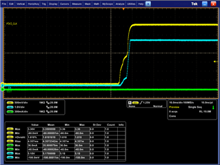

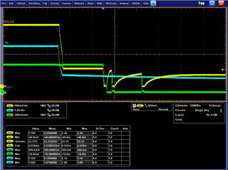

1. For TPS7A8001 For P3V3_CLK (1A, 0.364A), power-on/off is normal at no-load, and there is a large loopback when power-on/off at full load with 0.36A, which may cause the power supply to turn on by mistake. Please refer to the attachment for detailed waveforms
100% load , Turn ON
100% turn off
0% Load  turn ON
