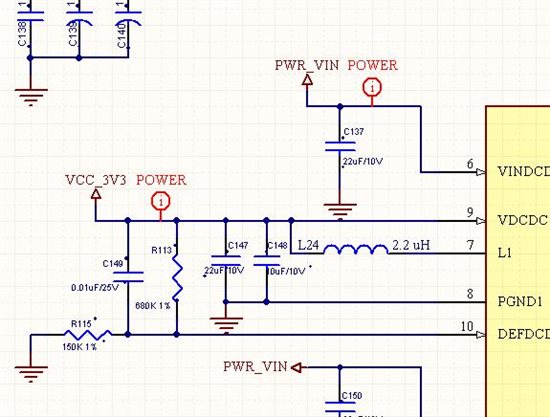

This is regarding the TPS65023 PMIC.  We are using DCDC1 of TPS65023 to give 3.3V output and to do that we have connected resistance as per data sheet suggestion.

        2. DEFDCDC1 connection. Although it is according to the application note, it is still strange, this pin is not FB line according to the datasheet, but it is referenced to VOUT (3.3V in our casE). We suspect that there might be some kind of race on this line.

    I am doubting the defdcdc1 pin connection - Y'day I tried lower value of voltage devider  on that pin [84.5K and 18.2K instead of 453K and 100K] - It helped me to resolve this issue in one board but unfortunately on different board same issue occurred [ofcourse with laser frequency earlier board was failing 5 out of 5 time I do the experiment but now it fails 3 out of 5 times].

  • I too had the same issue with my DM365 based design. We were also using the same configuration like
    DC/DC1 for 3.3V
    DC/DC2 for 1.8V
    DC/DC3 for 1.35V.
    We also had same condition, what we found is the issue with the power sequencing. our sequencing was 1.35V->1.8V->3.3V, 3.3V was our last power supply.
    Main culprit was a capacitor(c149) that we added in the feed back loop of 3.3V
    Due to this capacitor the  3.3V is getting ramped before the 1.8V get stabilized. causing the internal clamp diode of DM365 to latch and cause the 3.3V supply to come on 1.8V power rail
    Wave form is shown below:
    yellow is 3.3V ramp and blue is 1.8v
