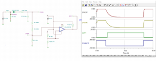

  • I tried to use the LM2903B spice model from TI and input the MACRO on the TINA schematic.  The part is supplied with 12V and a divider (also using the 12V) is on the noninverting input of LM2903 triggering point at 6V (100k/100k divider).  I connect a 12V to an RC circuit and connect that to the inverting input of the LM2903. When I run the TINA simulator, LM2903 triggers between the rail voltage 12V and GND, but not at 6V.  Am I using the macro incorrectly?

  • Hi Luis,
    Can you send me your tina sim file?
     Most likely the issue is that you are violating the input common mode range (VEE to VCC - 2V). In this case we have the model give out an error condition by going to mid supply when the common mode range spec is violated. This does not happen in the real device
  • Hi Luis,
    The model is working as intended. I am not sure I am following what your issue is. "270DIV" drops below the reference voltage of 5.74V at IN+ in which the comparator goes HIGH at 12V. "270DIV" swings above 5.74 and the comparator goes LOW, close to GND. Can you explain what you were intending it to be?
    I would also consider increasing the pull up resistor size, 12V with a 5k resistor would burn more power and increase the risetime and timing of your circuit. 12kohm or more would be good.
    I also see a floating 1MEG resistor at R3. Was this supposed to be connected?
  • Hi Chi,
    Thank you for the feedback. Actually, I ran the TINA simulator, again and it runs fine. Not sure what happen, but I have another question. When I ran the simulator, the waveform I got for the "SOURCE" has a slow rise time (about 90ms). Is there a way to reduce the rise time similar to the fall time for the "SOURCE" waveform? See the simulation output for the file I sent you in the previous message.
  • Hi Luis,
    I believe the fall time and the rise time is affected by the charging/discharging of your RC network of R166 and C170 (RC time constant). Consider playing around with the values, such as increasing R to 200kohm.
  • "SOURCE" is connected before the RC network. Not after. I understand the Fall time, but not the rise time. No problem. I am using LTSPICE and is does not exhibit this behaviour. Thanks anyway.

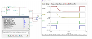

  • Hi Luis,
    Here is what I got. But of course this would change your divider voltages. It may also have to do with the switch. But I am glad you didnt see the issue in LTSpice. Thanks.
  • Sorry Luis, found it was also a TINA related issue. Here I changed the TR max time step, since you simulated for 6 seconds, i set the time step to 6ms and got better results with the original 10kohm resistor.
  • Thanks. I will try it on TINA
