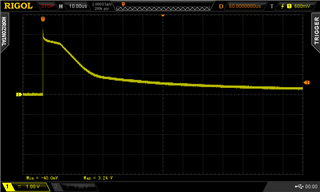

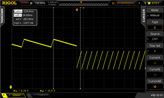

Also here you can see how the BQ76200 in our design behaves.
As mentioned, there are just few devices whit this issue and we also couldn't recognise any error patterns or when this problem occurs:
Figure 2: BQ76200 Hiccup Mode

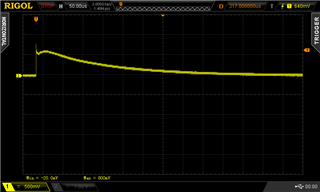

Figure 3: Successful switch-on on the same device as in Figure 2

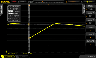

Also I want to share the measurement of the gate current measured over R46 (100R on CHG side) and over R43 (100R on DSG side)
Figure 4: Gate current on CHG side measured over a 100R resistor
Figure 5: Gate current on DSG side measured over a 100R resistor
By the way, we can reproduce this failure only if we load the battery with a resistive load. In our case its approx. 3R @ 53V battery voltage
