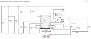

This is the schematic from webench:
I see tht they dont use a switch here. I guess an easy way would be to use a transistor on the latching swich side? but im not sure where the Gate on the transistor will get its voltage from when everytihing is off.

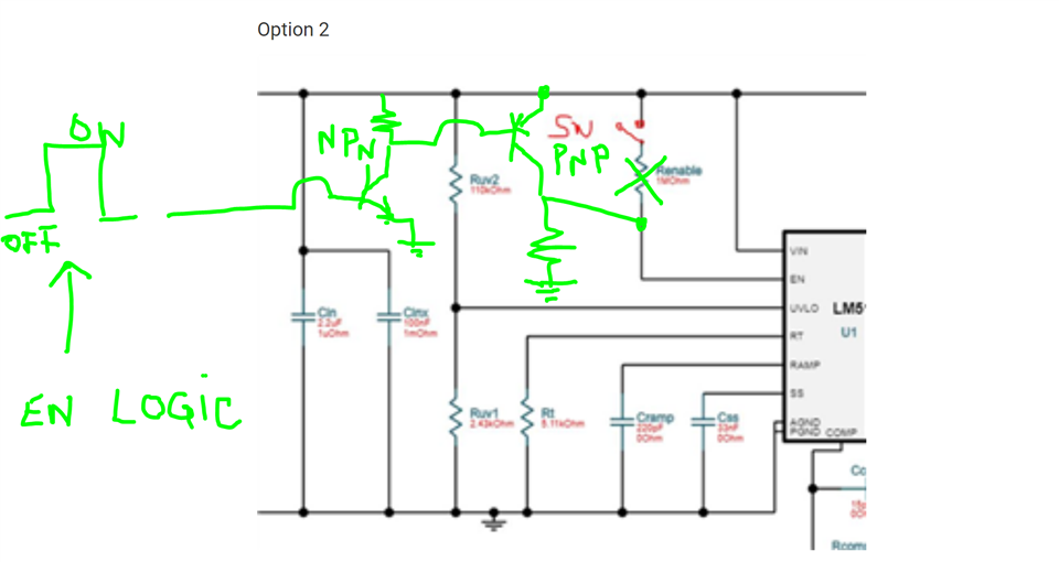

    Pardon my ignorance please, but how would an N-channel mosfet work to switch on the LM5116? The MOSFET would need a +ve voltage at the gate to enable the path from UVLO to Gnd. How do you suggest powering the mosfet gate?

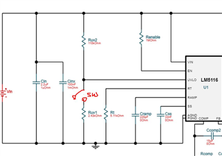

    Would solutions like the below work or do they need additional circuitry to avoid damage to switch and LM5116:
    Option 1
    Option 2

  • Hello Mohamed,
    Reading this thread, I am assuming your concern is the fact that with everything "off" you see a conflict with the logic as you would have to supply a voltage to the base of the NPN resulting in an off condition.  I suggest using proposal of concept below, that way everything is off when no voltage is present to the device or its sub circuits.
    When the voltage is present at the base of the NPN the device will turn on, when no voltage is present at the base of the NPN, the device will turn off.
    Hope this helps.
    David.
  • Thank you David. For the sake of simplicity, what is the reason my proposed solution of adding a switch directly between UVLO and Ground or En and Vin will not work?
  • Hello Mohamed,
    The solution I proposed above has the correct logic in terms of power draw from VIN.  I assumed you wanted only to activate the LM5116 when input power is present.  i.e., Power present at input, Turn on LM5116.  Power NOT present at input, Turn LM5116 off.
    Hope this helps.
    David.
