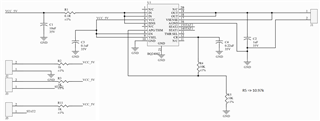

  • Hello
    You can see our schematic below the writing.
    I want to give some details about projects. We are using J2 and J5 to connecting LEDs which one is green and the other is red. Red LED just for seeing when battery charges. Before connecting battery and after battery charged Red LED goes off. Green LED for POWER interface to see if charger connected electricity or not.
    R4 = 10kΩ
    R5 = 10.97kΩ  => we are ensuring that with 2 serial resistors like that => R5 = (10.kΩ + 0.47kΩ)

    So this schematic is for BQ24002. We want to completely preserve this schematic without BQ24002. We want to change BQ24002 with BQ24008  with this schematic.
    Thank you.

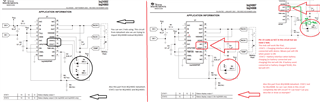

    -I want to make sure we can use stat1 and stat2 with different leds right? Because we need a led to learn power is ON and other led for Battery charging. We need 2 leds. We dont want to use bicolor led or equivalent.
    -According to datasheet we should stat1 and stat2 with different leds. But how? Can you describe or draw it? Because there wasnt an example about it in datasheet.

    If I understand right, Stat1 and Stat2 in BQ24002 works open drain as default. Also BQ24008's Stat1 works like open drain as default but BQ24008's Stat2 not work like open drain as default. So how can I set Stat2 as like open drain if I can? Im still exploring..
    Thank you from now.

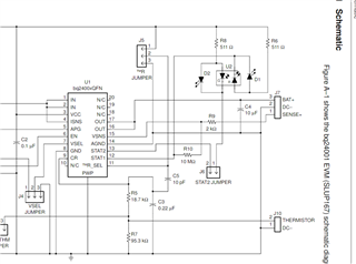

  • Hi Anil,
    I wasn't aware there was an active thread already. To prevent duplicate answers between Bill and I, let me answer here. I will close the other one.
    I pulled up a schematic we have and it shows the following:
    so I believe your schematic is fine. Can you provide a waveform for the STAT2 pin, STAT1 pin, and battery voltage?

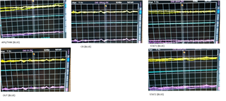

    Oscilloscope Measuring Results
    APG/THM - 1.42-1.46-1.52 (ΔV=0.04)
    CR - 2.82-2.86-2.88 (ΔV=0.04)

    Also i will add oscilloscope screens that i use R4=10k and R5=10.97k
  • Hi!
    I have a different result but I've only seen it once for 5 mins. I will try to send videos if the internet allows. I think that was pwm so what should i do now?
  • Hi Anil,
    Can you share what the waveforms are? What is CH1?
    Anthony Pham
  • The square waves are stat1 pin waveforms. Others not connected.
  • HI Anil,
    This lo oks like the behavior of the BQ24007. Can you confirm the IC markings on the device?
