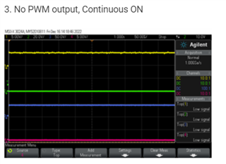

ISSUE OBSERVED DURING TESTING:
1. First we provided the supply voltage (24V) to IC and check if there is any short.
2. Later, we provided the control input voltage to check the PWM output from out pin.
3. Initially the delay time is observed as per calculation and could witnessed few PWM signals.
4. After few sec (approx 30sec), the IC didnt provide PWM signal and the output pin was in continuous mode
5. Later we removed the daughter PCB from main PCB and repeated the test separately by powering the IC and control input voltage.
6. At that time, we could be able to see the PWM signal continuously, and solenoid also connected across the diode (24V & output 0V)
7. But the IC produce more heat and the heat does not able to dissipate even we provided 4-layer PCB copper pouring for better heat dissipation.
8. The IC exhibits more than +85Deg C in ambient temperature of +25Deg C
9. But as per datasheet, the temperature rise calculated is not matched with the practical data. Also, we loaded the IC only 250mA in PWM mode (1A in continuous mode)
10. If we removed the Solenoid load and tested in open condition, even though the IC generates more heat when PWM output is ON completely.
11. Also, we replaced the IC DRV103U and repeated the same test, the IC produce the distorted PWM waveforms and IC becomes more hotter (>+85Deg C) than the DRV103H

1. Initial condition:
Yellow: Status Flag
Green: Output
Blue: Input
Pink: NC
2. Ton is Higher: (theoretical: 28.9uS for 30%DC, 24KHz)
3. No PWM output, Continuous ON

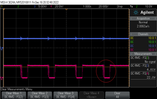

4. Driver IC tested separately and output is working with ringings:

8. The Ton+Toff time is correct, but why Ton time is not matched with theoretical data.
9. Why ringing is produced in the PWM signal. Refer the above waveforms marking.

    Driver IC tested separately, and output is working with ringings pulse falling edge.
