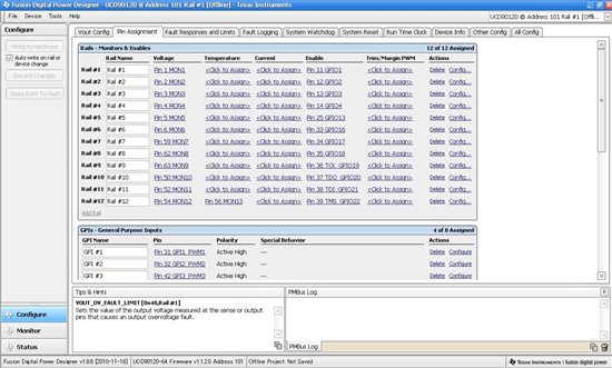

            I got the evaluation module. Now my chip is already mounted on board. Isolated this device using header assembly and connected to evaluation module. Configured the device. And is reading the reading also.
            UCD90120A has 13 inputs. But in fusion GUI I am able to add only 12 rails. How can I add the 13 th input (Pin 56 : Mon13)
       Sebastian V P
  • The 13th MON can be added as a current or temperature MON to an existing voltage rail.
