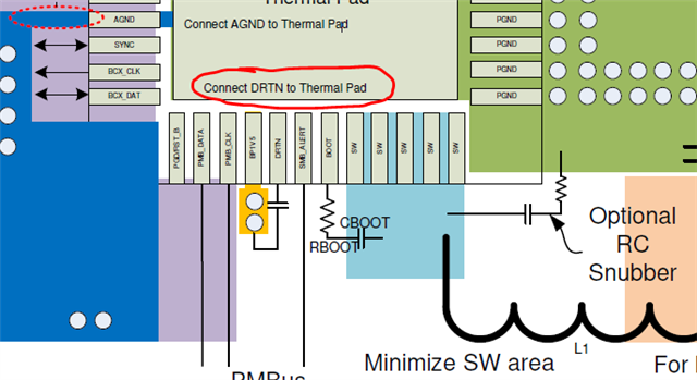

2. there's a conflict there, pin definition said don't connect anything to DRTN but layout example says differently,
please guide us the right direction
    The comment in the graphic is an error.   DRTN should NOT be connected to the thermal pad, or any other net or component other than the ground terminal if the BP1V5 capacitor.
    DRTN is internally connected to AGND.

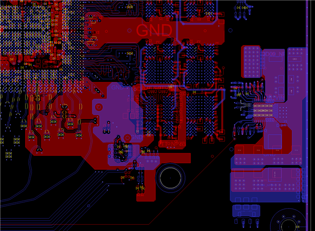

  • Hi Peter,

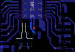

    here's their layout,
    as you can see the AGND PGND connection is one 0ohm,
    1.so actually AGND is connect to 0ohm through a "Via" first, and then through multiple vias back to thermal pad, do you think this is acceptable?
    2. they want to add extra three 0ohm parallel, do you think it's necessary or helpful?
  • 1.so actually AGND is connect to 0ohm through a "Via" first, and then through multiple vias back to thermal pad, do you think this is acceptable?
    No, that is not acceptable.
    The AGND pin should be connected to the Exposed thermal Pad through a minimum 0.15mm wide metal trace between the AGND pad and the Exposed Pad PGND on the mounting surface with no VIAs between the two.
    If a 0-ohm resistor will be used to separate the nets, it should be placed between the AGND pin and the AGND net.
    No resistors should be placed between the AGND pin pad and the Exposed PAD (PGND) routing to any number of resistors, whether 1 or 4 in parallel is not acceptable.

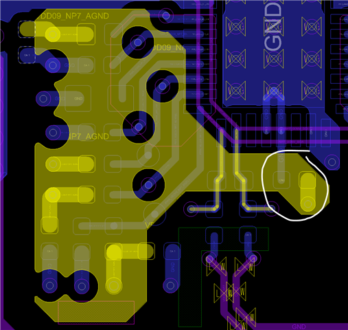

  • Hi Peter,
    1. can they use a 0ohm to connect to NC pin , and then NC pin connect to thermal pad instead?
    so no more vias,
    I know it's not the best solution but at least it's better than what it was.
    this is what they can compromise since they're restricted to naming rule, so have to use 0ohm to separate A/PGND.
    2. as above mentioned if they use a 0ohm as only connection between AGND to NC pin(PGND), does the number of 0ohm matters?
    or one is already enough?
    If they need to separate the AGND net and PGND net with a 0-ohm resistor they should:
    1) Connect the AGND pin to the PGND net
    2) Use a resistor to connect the AGND pin to the AGND net
    Do not place a resistor between the AGND pin and the Exposed Pad.

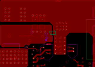

  • Hi Peter,
    1.as you recommended, use a 0ohm to connect AGND pin and AGND net,  but  most of area of AGND plane is in layer 3.
    please check
    2.please check the Cout placement
    as you can see, still two MLCC  are in bottom side (six at top) due to the area constraint.
    and the SW area is reduced.

  • 1.as you recommended, use a 0ohm to connect AGND pin and AGND net,  but  most of area of AGND plane is in layer 3.
    No problem having the majority of AGND net on internal layer.  This looks  good.
    No problem having some Cout capacitance on back-side of board.  In fact, the lowest output impedance is typically achieved with half of COUT on backside of the board, placing mirroring output capacitors on top and bottom of PCB.

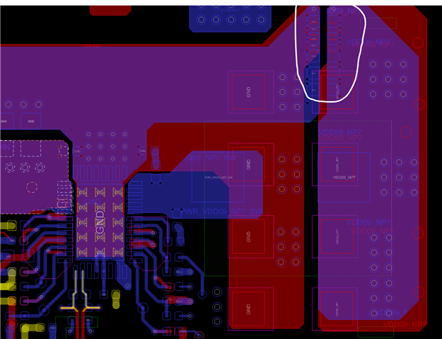

    Some recommended improvements to the layout
    1) Move the high-frequency bypass capacitor on the back-side of the PCB under the PVIN pins and add some additional PVIN vias as close to the PVIN pins as design rules allow.  This keeps the loop of the PVIN bypassing in the plane of the board and offers better switch node ringing reduction.
    2) Expanding the back-side PGND copper area beyond the device will also help with thermal dissipation to the ambient air, reducing device operating temperatures

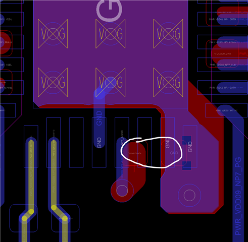

    3) There appears to be a component between AGND and PGND at the AVIN and VDD5 bypassing capacitors.  The only connection from AGND to PGND should be mounting surface connection from the AGND pin to the exposed thermal pad.
    This resistor should be connected between the AGND island and the AGND pin, not between AGND at the AVIN bypass capacitor and GND at the VDD5 bypass capacitor.  This configuration will introduce a lot of PGND noise between the AGND net and the AGND pin.
    Looking through more of the layout, it looks like there are more AGND to PGND resistors spread through the layout, creating significant ground loops between AGND and PGND, which could further interfere with device operation.  There should only be 1 single-point connection between PGND and AGND, and that single point connection must be the direct connection from the AGND pin to the exposed pad.
    It would be better to connect the AGND to PGND resistor directly to the AGND pin rather than connecting the AGND to PGND resistor to the NC pin, and then the NC pin to the AGND pin through the Exposed Pad.  This will minimize PGND noise between the AGND pin and any AGND components.
  • Hi Peter,
    about third point.
    although they have several A/PGND connection, but they DY most of them only leave the one close to  thermal pad.
    further more, I think you mistaken the pin location,
    if you could take a closer look, it was already the AGND pin instead of NC.
    they just named it the same, so easy to confused.
  • You're right, sorry about that.  I had the order of the pins flipped.

  • Hi Miller,
    would you suggest these MLCC move to left side  and parallel with four POSCAP since the loading is on the left?
    the location of MLCC right now is at the rightmost side of the board , just want to know if this concern you?
    22A120-SA-0111WPH0403.brd
    Please do not add new questions to an existing thread, that makes it much more difficult for others with similar questions to search for and find answers.
    For the lowest possible output impedance and output ripple, I would recommend dividing the MLCC capacitors between both right and left as well as top and bottom.  That will provide the lower impedance by providing more parallel conduction paths for the high frequency currents to flow in, reducing current density and thus impedance.
    As a general rule, we want the smallest, highest frequency capacitors split, with half near the load and half at the inductor, building back towards the largest value, highest ESR/ESL polymer capacitors in the middle.
    Local MLCC at the inductor's output voltage terminal provides a low inductance path for high-frequency noise and cycle by cycle ripple to return to the synchronous rectifier and input capacitors through ground, limiting the high-frequency currents flowing in the electrolytic / polymer capacitors while remote MLCC at the load provide a low output impedance to improve the high-frequency transient response.
