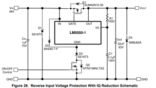

I want to cut off the input of Vout pin and GND pin to reduce the leakage current when it is not use.
If Vout pin and GND pin Keep floating , Will the LM5050-1 keep MOSFET off? Does the Gate-source resistance low enough to discharge the Ciss?
