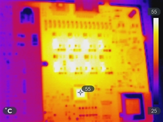

We are using BQ76952 in a 16S configuration with external balancing N-MOSFETs. As recommended by TI in Cell Balancing with the BQ769x2 section 2.2 External Cell-Balancing Circuit Design Using N-Channel FETs. Here we have observed that during normal operation(voltage and temperature measurement no balancing) with ambient of 25 °C the AFE die temperature reports to about 45 °C.  in this condition when balancing for alternate cells is turned ON (8 cells in total) the temperature reported by AFE goes to about 60 °C. Our product is designed to work at 55 °C ambient temperature, which means we would cross the max operating temperature of 85 °C when working at our max ambient temperature and start the balancing operation
1. Is this behavior expected? if no then what can we do to reduce this rise in temperature?

Thermal image of the Board: ( 60 degree die temperature reported by AFE)(alternate cells being balanced)

    The ways you mention I believe may be the only possible solutions to decrease the rise in the temperature. You can adjust the number of cells being balanced or adjust how/when the cells are balanced. There is some discussion about it inSection 2.1 of the Cell Balancing app note.
    However, I am surprised there is that much of a raise in temperature at the IC, could some of the heat from the external cell balancing reaching the IC? If you balance less cells at a time, how does the temperature get affected? Or is it similar?
    I would not expect a big raise in temperature in the IC since your input resistances are 100-Ohm.
