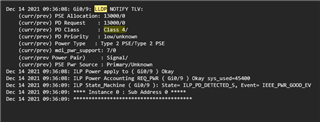

Our client who we produced this device for requires it to work with LLDP however, until now the device cannot successfully negotiate the power it needs  (31.1 watts).
We are trying to work through this issue with our client but we have hit a wall and are now trying to sort it out.
Since the TI TPS2373 is the chip we are using for PoE we believe your team will be able to help us clear the issue up.
Below you will find the spec sheet for the exact chip we are using as well as a snippet from the port setup showing the issue.
Any help your team can give will be greatly appreciated.

    It looks like your PD is configured for Class 4 power level. According to the 802.3at and bt specification, the PSE can source up to 30W for this power class and the PD is only guaranteed 25.5W power delivered. This is why you are not seeing the power levels needed. The PD hardware design will need to be modified to a class 5 PD. I would also check to see if the PSE is Type-3 capable and able to deliver the power you need.

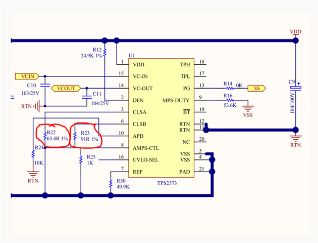

    We have reviewed and currently we only have one pair of resistors for classification and the TPS2373 only has one pair of PINs for classification.
    We are not sure how to enable 4 pairs, do you have any insight on this?

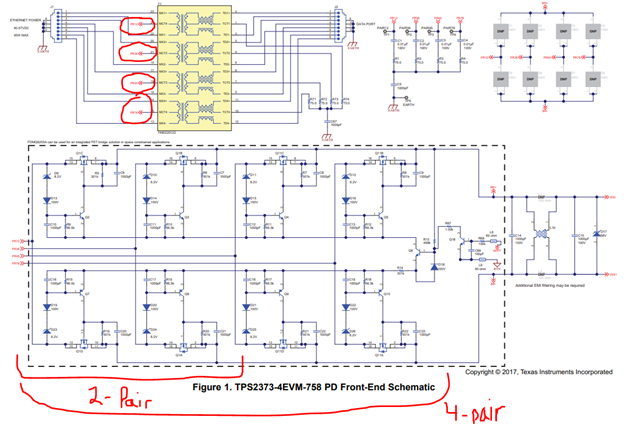

    Attached is the circuit design any help you can give would be amazing.
    Schematic

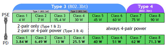

    Classification is achieved using the pair of CLS pins and truth conditions to negotiate power class. Please see table below for truth table and CLS resistors to select proper classification. I have circled Class 5 since it seems you will need Class 5 Power in order to meet your power needs of device,
    Per your schematic, it seems you are requesting Class 8 power which can only be acheived using 4 pair.
    Since you are requesting Class 8 power and not seeing full power need, I would suggest checking the capabilities of the PSE you are testing with. It seems the PSE is a Type 1 or 2 PSE and can not support 4 pair power. Therefore, your power will be limited to Class 4 which is 30W at the PSE and 25.5W at PD.
    Enabling 4 pair power on the PD is a slight hardware modification, however if the PSE can not support 4 pair power then you will not be able to achieve this. 4 pair power on the PD can be configured on the hardware from the RJ45, Data transformer, and recitifcation circuit. Please see below example from TPS2373-4EVM-758.

    Thank you for the reply! We have reviewed thoroughly and talked further with the engineering team.
    Their reply is that the design we used is based solely on the same reference you provided in the above post however it is still not reporting the class 5 it needs.
    Attached you will find that the spec sheet for the PoE board and the general schematic.
    We are unsure where to go from here or how to fix the issue.
    Any help you can give is greatly appreciated.

    Yes it seems your design is okay. Your device is requesting Class 8 power which can only be sourced from a Type 3 or Type 4 PSE. Type 3 and Type 4 PSE support 4 pair power which is what is needed to supply anything >30W. The PSE you are testing with is a Type 2 PD which can only support up to Class 4 power (2-pair) which is not enough to meet your requirement.
    In order to test this board, you will need an IEEE802.3bt standard PSE. I recommend using our TPS23881EVM in order to achieve this, which is an IEEE802.3bt device capable or supply up to 90W over 4 pair power. For this EVM you will need TPS23881EVM-008 daughter card, BOOST-PSEMTHR-007 mother board, USB2ANY for I2C, and TPS2388x EVM GUI along with SRAM v07 which can be found on TPS23881 product page.
    Can you attach your full schematic so I can review if your device is set up for 4 pair power? I have sent you a friend request which includes my email so we can setup a meeting if needed. Thanks!
