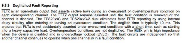

TPS2064C-2: Can you please tell me about the overcurrent activation conditions for the TPS2064C-2?
Part Number: TPS2064C-2
Hello.
My name is Shuta Miyashita from Toshiba TEC Corporation.
I have a question about the TPS2064C-2, which is a current-limiting power distribution switch.
Please see the table below.
The condition is that the FLTx signal is asserted. Is it correct to say that if this condition is met, the overcurrent will not be activated?
