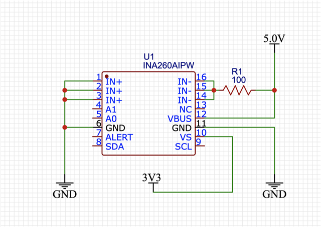

  • Here's a screenshot of a schematic...
    Well - that would be great... I've made the screenshot, but how do I get it into a reply?? Insert has no file selector in the insert menu???? I've wasted 20 minutes on this - how does this thing work??
  • OK - finally figured it out! The "Insert" dropdown threw me off completely!
    Anyway... This how I've got my INA260 wired. It seems to be working - in the sense that I am able to measure a negative current. But I remain puzzled, in part because I do not see why this was necessary. I had to give some thought on how to wire this simple circuit to yield a "negative current", and of course TI's spec sheet provides the obvious example (positive current).
    My question seems to come down to this: Can you show me an example of a measurement case which requires one to measure negative current? I can't... And since the data in the Current Register (01h) is two's complement (which requires different handling in my application code), I'm curious to know what's behind the design choice made by TI.
    Yes providing a higher potential on the IN- side and a lower potential on the IN+ side will result in "negative current" flow. I guess I did not understand exactly what you are confused about.

  • Hmmm... Yes, current would be flowing in both directions, and that would be a great application. But how would you bias Vbus for this application? Is there a schematic for that? Let me think on this a bit...
    The Vbus can be placed either on the IN- or IN+ pin. When the current is bidirectional you will most likely measure on the high side of the load.
    Here the INA IN+ pin will be towards the circuit/charger and IN- pin will be towards the battery positive terminal.
    If placed in the IN+ pin:
    Positive current: Current from external source to batteries. The Vbus will be at the potential of the external source.
    Negative current: Current from batteries to circuit. The Vbus will be the battery potential minus the Vshunt drop.
    If placed in the IN- pin:
    Positive current: Current from external source to batteries. The Vbus will be the external potential minus the Vshunt drop.
    Negative current: Current from batteries to circuit. The Vbus will be at the potential of the battery source.
    Either way the voltage at Vbus will be similar.
    If you want to measure low side current and still measure power you can place the Vbus pin at the positive side of the load.
