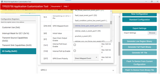

In the TPS25750 Application customization tool, I saw GPIO Mapped event (37,39 description as the picture shows.)

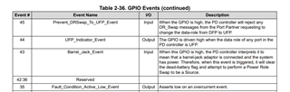

But in TPS25750 Host Interface Technical Reference Manual, the event 42~36 are reserved.
1. Could you pls tell me where I could find the detailed description of the GPIO event related to the GUI tool?

    1. Please use the TRM as a guideline for available GPIO events, unlisted or reserved events (such as events 37 and 39) should not be used. We're working on removing these reserved GPIO events from the TPS25750 GUI.
    2. The TPS25750 does not have the capability to record a GPIO being held low/high for some timeframe.
