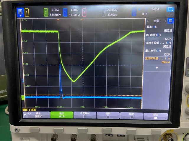

I asked this question because we met an issue in customer side.
You can see below waveform: the blue one is load current, it shows a transient overcurrent (~12.2A) because a light is turned on in system. The origin load current is ~700mA. The yellow one is output voltage. It seems be limited but then turn to normal. But as datasheet described, the device should immediately shut off current. I was wondering why the output voltage go down and then back to normal. Does the device enter into startup mode?

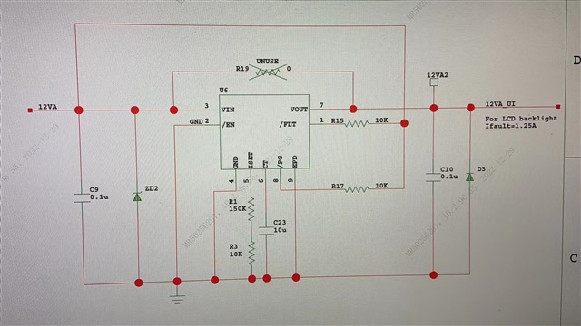

I also attached the schematics for your reference. Could you pls help to review it? Thanks a lot!

Please probe VIN,CT and FLT pin also to comment better like below:
Where is the current measured?
