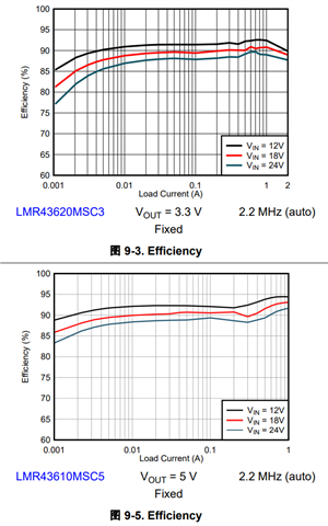

Hi Team,
Could you recommend a buck converter could meet below requirement?
- Q-grade
- Vin 12V, when Vout is 5V, 200uA, buck converter input current < 100uA.
Thank you.
Hi Team,
Thank you.
HI
I will recomend LMR43210 with fixed 5V option. below is its efficiency in datasheet
