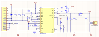

Can you please verify this 2S battery charging design?

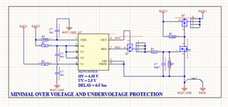

I am using this device along with BQ296100. Thus the SYS pin gets affected by this IC?
  • HI Syed,
    I don't see any obvious issues on the schematic.  I couldn't read the resistor values.  This device is very sensitive to input line inductance.  I recommend increasing VBUS capacitance to 4.7uF and PMID capacitance to 22uF.
    Jeff
    Thanks for the reply. I have modified those changes.
    Here are a few questions:
    I have shorted the D+ and D- with a 100-ohm resistor. Is it okay or do I need to short directly?
    I have connected the load to SYS pin (The load avg current is 2.5A and max current is 4A). Is it okay? does BQ296100 affects the functionality of SYS pin?
  • Hi Syed,
    BQ296100 is a pack protector and so should not load SYS.  It is okay to use a 100 ohm resistor to short D+/D-.
    The BQ25886 max battery (and therefore SYS) output current is only 2.2A. It will not be able to provide the 2.5A avg and 4A max without supplementing from the battery.  This means the battery will likely never charge.  I recommend changing to BQ25798.
    Jeff
    We don't want any communication interface. That's why we chose this IC.
    Is it okay to leave the SYS floating and connect the battery directly to the load?
  • Hi Syed,
    It is not recommended to do that but again, the max output current is 2.2A and your system needs 2.5A avg and 4.5A max so I don't think the battery will ever charge.
    Jeff
    Thanks again.
    Here are few follow up questions:
    1. What if we don’t need the power path? Can we just connect the load to the battery? Also, the device will be completely off while charging so load current consumption will be in milliamps
    2. If no, then is there any other way to charge 2S battery with 5V USB Supply?
  • Hi Syed,
    Regarding 1, not recommended but since there is no load while charging, I see no issue with tying the load to BAT or to SYS.
    Regarding 2, BQ2588x is TI's only 5V to 2S LiIon charger.
    Jeff
