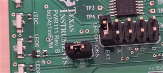

unfortunately I have hit and confirmed the I2C to HDQ button.
Is there really no way to change it back?
You can still change it back to I2C by re-flashing the gauge using the default srec file. You can find it in ti.com. Design and Development > Software Development > bq34z100 Rev.B Firmware.
Please refer to section 3.5 in this user guide to program the default srec file.
https://www.ti.com/lit/ug/sluu904b/sluu904b.pdf?ts=1672262013759&ref_url=https%253A%252F%252Fwww.ti.com%252Ftool%252FBQ34Z100EVM

That's the EVM revision. I will need the version that displays on bqStudio.
Jose Couso
If you are using bqStudio, look at the left panel on the screen. Or I can send you the one I have on the screen.
