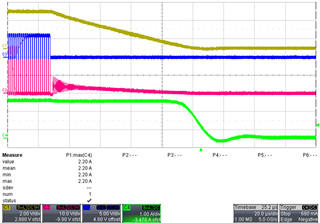

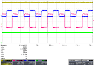

  • Hi Tiger
    As mentioned, it is an lC level test parameter; does it mean that it is gained by the open loop test?
    Once I consider the BQ24800 as a generic buck converter and pulling the current with constant-current load @ VBAT instead of connecting a battery, as a result, the REG0x14() seems to be treated as the level of overcurrent
    Please refer to the captured waveform as follows
     0x14() = 0800 = 2048mA
     0x15() = 2800 = 10240mV
    CH1: VBAT: CH2: HIDRV: CH3: LODRV; CH4: IBAT
    IBAT = 2A Continuous (CC Load)
    IBAT = 2A to 2.1A
    IBAT = 2A to 2.1A
    Whether I can conclude this behavior is over current protection or not?
    Should I check something else to make sure?
    Thanks for your suggestion and comment!
    Ben
  • Thanks Ben for the detailed waveforms.
    I don't think this is CHG_OCP, you are far away from 6A CHG_OCP level.
    This part is designed to work with a battery. The behavior may be different if pairing with an active load. It is not recommended to use as a generic dcdc converter.
    Tiger
