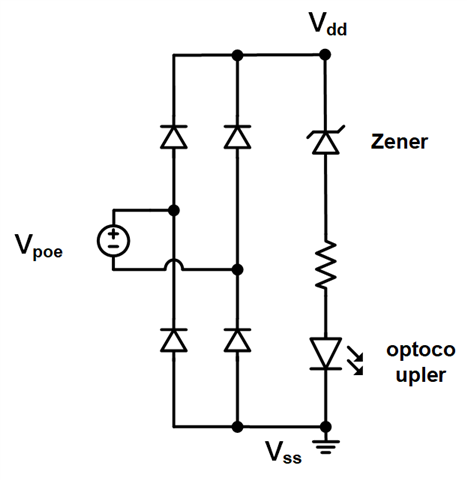

    For passive PoE injector, if PPD (triggered by the voltage between Vdd - Vss) is used, it will also make T2P low. May I know what is the voltage of the passive PoE injector? The PD's input voltage is 36 - 57 V for standarded PSE. If the passive PoE injector has a lower voltage (like 24 V), then using the circuit below could help the MCU recognize the passive injector.

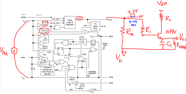

    One possible way I could think is using a circuit below. When with the af PSE, it will go through classification (when Vdd-Vss = 9 to 22 V) pulse which will make CLS = 2.5 V for 10-75 ms. Then the voltage of C1 (Vc1) can be charged to about 2.5 V - 0.7 V = 1.8 V when with suitable R1 and R2 values. When with the passive PoE injector, CLS will also be 2.5 V for a much shorter time when Vdd-Vss = 9 to 22 V, then Vc1 could be much less than 1.8 V.

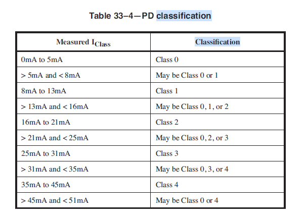

    R1 and R2 values should be much larger than the classification resistance Rcls since this detection cannot influence the classification current as the table below. A bleeder resistor (Rbleed) needs to be large enough too since it need to hold the Vc1 voltage higher than a certain value unit the MCU is powered up.
    When MCU is powered up, the Vc1 voltage and T2P could be monitored, if they are both High, it will be af. T2P High and Vc1 Low it will be passive PoE injector. A High threshold voltage of Vc1 also need to be carefully designed.
