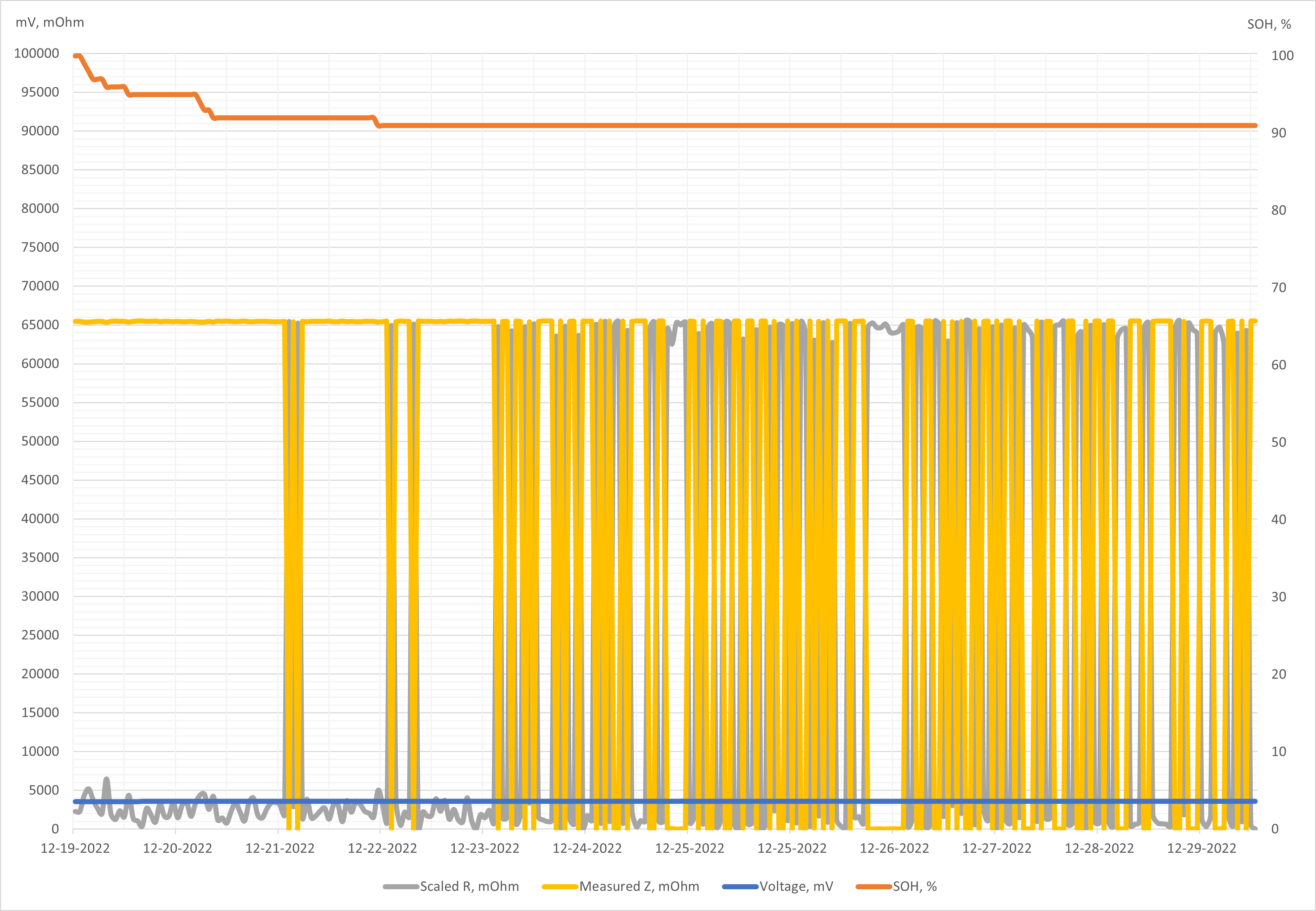

Equipment: BQ35100 chip is connected according to the datasheet and controlled by I2C via MCU. The GE and ALERT output are also controlled by the MCU. An XBee module is used as a load, which in transmit mode consumes 20mA, which creates a voltage drop of 80mV.
Power source: two SAFT LS14500 batteries connected in parallel. Voltage 3.6V, capacity 5200mAh, Li-SOCl2 chemistry.
I connected the EV2300 programmer via I2C to the BQ35100 and calibrated the current and voltage on the chip according to the SLUUBH7 and SLUA904 manuals in the BQ studio program. Then set battery parameters, operation config A to EOS mode and updated chemistry ID to 0623 (Ra table updated). All parameters can be viewed in the memory dump. Then I unplugged the EV2300 and further tested the new battery to full discharge using the MCU.
Measurement algorithm:
1) Enable GE pin.
2) Read battery status.
3) Send GAUGE_START command.
4) Wait for GA bit.
5) Send a command to the XBee causing a voltage drop of 60-80mV for 2 seconds.
6) Send GAUGE_STOP command. Within 15 seconds, the consumption is minimal.
7) Wait for ALERT to go low due to the G_DONE.
8) Read Voltage and SOH.
9) Disable GE pin.
Then two functions are used to read Scaled R and Measured Z. Each function consists of:
2.1) Enable GE pin.
2.2) Read battery status.
2.3) Read value.
2.4) Disable GE pin.
(Although now I understand that it was better to read the parameters after the main measurement without switching the GE pin)
These three functions were performed every hour. After the measurements, the XBee data transfer function was turned on, which provided a consumption of 10mA. Thus, the battery should have been discharged in about 20 days. However, on day 11, I stopped testing, as the Scaled R and Measured Z numbers became frankly wrong. SOH value did not fall below 91%. I made a memory dump after testing and golden image.
Is there an error in the algorithm? Perhaps the chip settings are incorrect? I would be very grateful for your help in this matter.

  • Hello Vlad,
    Were the steps in TRM section 5.3.1 Initial EOS Learning completed?
    It i also strange that the voltage of the battery increased in the beginning of the log. Do you know if there is anything in the circuit that could cause it?

    I think this is an error in the BQ35100 voltage measurements. I don't know what else could cause such an increase in voltage in 10 days. The device has only one voltage source - two LS14500 batteries connected in parallel. Consumers: XBee S2C module, LED and MSP430FR5994 controller. The temperature is constant, 24 degrees.
  •     Have you tried to add a delay(like 1s) between G_DONE and read Voltage, SOH, ScaledR and MeasuredZ followed by disabling the GE pin
  • There is no delay before reading the voltage and SOH, I did not try to add it. I read these parameters as soon as the ALERT pin goes down due to G_DONE.
    But I read Scaled R and Measured Z after switching the GE pin (as described in the question, by two separate readings) and after G_DONE, exactly a second passes. Although it is in these indications that the greatest variation in values is.
  •     It is no need to switch the GE pin to read the Scaled R and Measured Z, this 2 values can be read together with voltage and SOH, but a delay may needed before reading all these data
  • I will run another test for >20 days and read all the readings together, one second after G_DONE, thanks.
    As far as I understand, the delay will help to remove erroneous jumps in values. But on my graph, the SOH value is stable for a long time. Do you think SOH did not fall below 91% precisely because of the lack of delay?
  •     The SOH and ScaledR, MeasuredZ are calculated at the same code section, if SOH is stable, then ScaledR and MeasuredZ shall also be stable, I think there might already be an unintentional delay before you read the SOH, reading ScaledR and MeasuredZ together with SOH shall return correct result.
        But only assert GE without gauge_start() command won't get correct ScaledR and MeasuredZ reading. When GE is pulled low after reading SOH, the devise lost its power and the content in the ram shall get all lost.

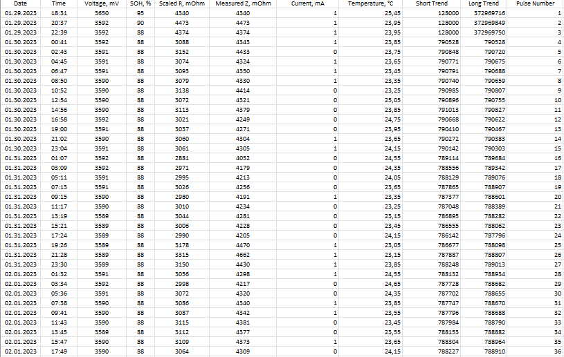

    On the consumption chart it looks like this:
    Such operation of the system should discharge a 5200mAh battery in 1 month and 12 days. That's about 2 percent a day.
    I calibrated the current, voltage and temperature readings on new board, set up all the necessary parameters and ran the test with a slightly discharged battery with a maximum delta SOH of 5%. In two measurements, the SOH value dropped to 88% and the value did not change for three days. At the same time, the readings of other parameters look valid.
    I attach a memory dump of the BQ35100 chip made before the test was run.
    Is the problem a small voltage drop? The voltage drop is only 40mV instead of the required 100mV. Or is it the wrong settings in my configuration? I am concerned about the value of "Cell Terminate Voltage" which is 2000 mV.
    config_before_testing.gg.csv
        For the scaledR value, it is getting lower over time from your logged data, it is not expected in normal application, this is because the scale changed from the 3rd row of your logged data, the scale used to scale the measureZ to Scaled R is 1.60x after 4rd row, this caused the following impedance always below 4xxxmOhm, lower Scaled R means higher SOH, but SOH is not allowed to increase, so it is stuck at 88% until the scaled R get greater than 4374
        Per you load profile, it seems to be very dynamic, the load fluctuates up and down at the interval from ms to s level, the ADC sample current and voltage at 8MS conversion rate, I wonder if the impedance can be calculated stably under such dynamic load. From you result, the impedance varies up and down randomly overtime. I wonder the SOH calculated with such impedance would be referenceable, please read below NOTEs in the TRM:
    "In EOS mode, the accuracy of the SOH reported value can vary significantly with a load profile. Perform in-system evaluation to determine the reported value at the desired EOS level. In some instances, the value of SOH should be ignored."
     Also please note the when a new batery is inserted, then the NEW_BATTERY() command should be sent to the device to ensure the initial learned resistance RNEW is refreshed correctly
      If the SOH is not referenceable, the major useful information for EOS mode are Short Trend Average and Long Trend Average, with which the gauge used to determine whether to assert Battery Status[EOS]

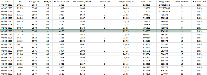

  • , thank you for the answer.
    I stopped this testing and did a memory dump. I got the value "R Table Scale" = 711. Is this normal?
    A very good point about impulses. I included a load resistor in the circuit and the pulse became stronger and without bursts. I'll use a new battery and the current will be 70mA (which causes a voltage drop from 3590mV to 3470mV). I'll run the test with it and also will describe the results.
    I also used the NEW_BATTERY() command in previous test to reset the EOS-related data. I forgot to mention it in the message.
    config_after_3_days_testing.gg.csv
  •     This is expected, the 0.711 is exactly the reciprocal to 1.406, the scale 1.60x in my previous post is a typo, if you check the ratio of the Measured Z and Scaled R, you will see a ratio of 1.40x
        As it is explained in the TRM, the load profile could be too dynamic for the SOH based on scaledR under EOS mode to be referenceable, you can use the short trend average and long trend average to determine the EOS alert if you still see a dynamic SOH data

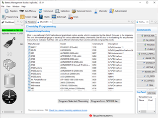

  •     You can press the Chemsitry button on the tool bar of bqStudio, then you will see a tab window for chemistry ID selection and download like below:
    Find the battery model matches to what you use in the project in the Column of "Model", select the row and click the button below to download all chem ID related data to the target device.
  • Yes, I did it at the beginning according to the manual, before creating the post. Even updated the database version. But this only changes the Ra table and the value of "Static Chem DF Checksum". Is not it so? I compared two configs before and after the flashing chemistry.
  •     The OCV table is hidden and not readable, what is the ID you used to download the chemistry data to the target device? What the cell modal type you are using
