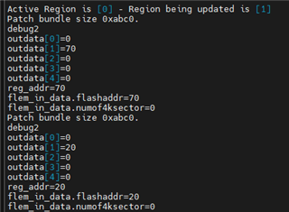

1. refer to SLVAE21A., in page 9. code snapshot.
Here I printf the above  code for debugging. so regarding this below outputs. Would like to confirm with TI if the results is expected.
1. outdata array outputs for the active region and inactive region. so here is reg_addr is 0x70  (after bit shift).  and 0x20.
2. the numof4ksector=0 , I assume the results should be 0x1000 (4096 in dec).
3.
flemInData.numof4ksector = TOTAL_4kBSECTORS_FOR_PATCH;
About the MACRO #define TOTAL_4kBSECTORS_FOR_PATCH   is it  0x1000 ?

  • Hi Sofian,
    In regards to your original questions about the App Note.
    The code is primarily for reference, and the original engineer is no longer with the team. In general, we recommend following the flowchart provided.
    I took a look at the code, and from my understanding, "flemInData.numof4ksector" indicates the number of 4kB segments required to hold the patch bundle. The comment you referenced gives an example of a max of "4", which would be 0x4 or 0b100. A value of 0x1000 would indicate 4096 4kB segments, which seems to be way too many. As the comment says, the patch size depends on your application and how large the patch you are adding.

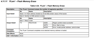

    2. Follow up the previous question and your answer, I execute the flem on region 1, it seems that region 0 also being erased.
    flem_data[0]=0
    flem_data[1]=0
    flem_data[2]=0
    flem_data[3]=70
    flem_data[4]=c
    FLEM cmd
    outdata[0]=0
    outdata[1]=0
    outdata[2]=0
    outdata[3]=70
    outdata[4]=0
    From my understanding, the formatting of the flash can change and when choosing the number of 4KB sectors to erase, you need to be sure it will not overlap with other regions. This could happen if you choose too many regions. If your flash is formatted like the figure below, you may be erasing from the wrong start address.
