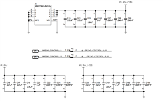

My customer is using LM5050-1 for redundant power supply. The schematic is as below.
When P12V_MB1 is removed and P12V_MB2 is normal operation, the ouput PIN P12V is normal, but P12V_MB1 (IN pin) has 7V stable voltage(not decrease by time) . Same situation when P12V_MB2 is removed, the P12V_MB2 has 7V voltage.

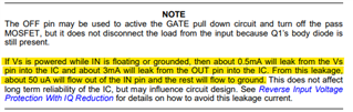

I notice in datasheet that, when IN pin is floated and VS is powered, there is about 50uA current leak out of IN. So is it the reason why there is a 7V voltage when power is removed? Is it a normal phenomenon and if not how to avoid it?

  • Hi dear,
    Thanks for your reply.
    I notice in that FAQ
    Either nFGD can be left open if not used or connected to IN/OUT through pull up resistor. Additionally this would not require PCB changes and hence recommended for designs that are close to mass production or at mass production.'
    In LM5050-2 datasheet, it says, it requires an external pull-up resistor to a voltage not higher than 5.5V, can it be left open? And, in my customer's system, the power rail is 12V, which is higher than 5.5V, can it use a pull-up resistor to IN/OUT? This might bring change to customer's PCB.

  • Hi Victoria,
    The nFGD pin is rated for a Abs Max voltage of 7V and a recommended operating voltage of 5.5V. So, the  nFGD pin can be connected to IN/OUT through pull up resistor if the max IN/OUT voltage is less than 5.5V. Otherwise, you can leave the nFGD pin floating.
    Please refer LM5050-1 datasheet snapshot below. When IN is floating and VS is powered, there will be continuous leakage current from IS VS pin to GND. If the PS2 is a battery, then he battery can drain due to this continuous leakage current into the IC and it is GND.

  • Hi Victoria,
    The leakage current is present when IN pin of LM5050-1 is floating. This means that that the PS1 battery is completely isolated and there is no chance of it being darined.
