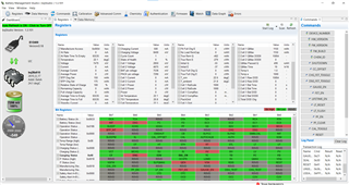

The bq28z610 can be well detected by BqStudio. When a resistor connected to PACK+ & PACK- on the EMV board, it also shows the state "Discharging" and the discharging current can also be read. However, the remaining capacity and Full Charge capacity are always 0 with "Relative state of charge" be 100% all the time during charging or discharging.
The configurations on the BQStudio:
1) DA bit 0 is set to 1 ( otherwise the voltage will drop to 3.7 which is voltage of one cell)
2) Gas Gauging configuration:
 Could the EMV board be used with a battery pack like this?( only two connections ) Since I cannot connect from battery pack to 1P on the EMV board, do I need to short it to 2P and pretend it's a one-cell pack? How should I configure the software properly to read the capacity and state of charge?

  • Hello Dian,
    bq28z610 is intended to be used where each cell connection is available. The protection features are cell based and without 1P, it is likely to get confused.
    A top of stack gauge like the bq34z100-G! may be a better choice
