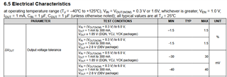

Is it designed to operate in parallel if I need more then 300mA it is providing?

I need 5V, and TPS7A21 does not provide it. And I may need to have up to 1A, so want to make sure this device will tolerate parallel operation.
Hi Leonid,
Can you use the TPS7A57 in your application? That will deliver up to 5A and will give you 5V output. The TPS7A57 will be a better choice for accuracy, however it will cost a few more dollars to implement.
You can parallel the TPS7A20 using ballast resistors. Please see these app notes and let me know what questions you may have. There is no way to connect the reference pins of each TPS7A20 so the error voltage, Ve, is the total accuracy of the LDO (see the EC table).
