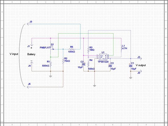

      here is the schematic of the circuit.
    The only omission from it compared to the prototype board I'm currently using is that there is an extra inductor between C3 and C1. I was just trying to isolate some HF noise going to the load, since this is the power circuit for a microphone, and noise is literally audible.
    The switch (the J177) is designed to take a high voltage, and switch off the charge pump if that high voltage is detected. This has been shown to work perfectly, and I have tried directly connecting the Vin and En lines together, and experience the same behavior explained in my original post.

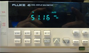

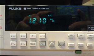

    I will note that the failure mode where it consumes tremendous current is not exclusively, but sometimes accompanied by the inclusion of the Fluke 45 current monitoring. It has a relatively small burden voltage (.14V in the range I'm trying to measure) and you can get it out of the failure mode with the Fluke 45 still connected in series with the battery.
     This is the output of the Fluke 45 during failure, and  is when through adjusting the load and taking the battery in and out of the circuit repeatedly it finally entered a stable operating mode. The 1.2mA seems quite high, as there is no load between J2 and J5, but working better than 51mA.

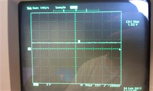

    The EN input   and Vin
    These both stay quite stable. There is a drop in voltage during the high current failure mode, where both lines drop to about 1.2V peak, and some noise is visible, which is understandable just from the ESR of the battery with those kind of currents being drawn through it.

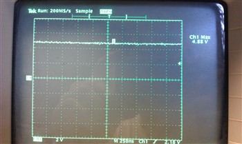

    Now is the interesting stuff: The output completely unloaded, 4.88V. Not the 5.5V that is supposed to be the max, but decent.

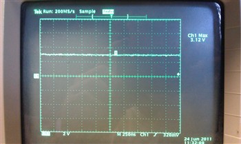

     What is interesting, that by connecting a 10k trimpot between J2 and J5, when its at its maximum value, this is how Vout looks The output voltage immediately drops to 3.12V. Since this is only 312uA of current delivered to this load, that seems like a shockingly low value to drag Vout down so far.

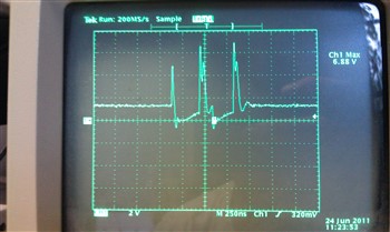

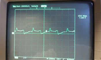

     and this is what the inductor L pin output looks like. I suspect this may be the heart of the problem, as I was expecting this to be a far more continuous signal, not nearly as periodic as its appearing, but it seems to always do this unless its in its high current failure mode.  this is the L pin during the high current failure mode. Obviously something is wrong, but I threw it in for illustration of my suspicion that the normal operation of the L pin should be far more periodic.

    If its possible can you share with me what the voltage output of the L pin should look like under these conditions? Is the Icoil on the datasheet on page 8 the signal that should be present there?

  • Thank you for your detailed reply.  Figures 21 and 22 show what the L node should look like.  Obviously, yours is different.  A few things to try:
    Use an inductor that is rated for a higher current.  As figure 22 shows, even at a very light load, the peak current in the inductor will be relatively high--150 mA.  Your inductor needs to have a saturation rating higher than this.  The inductance versus current graph for your inductor doesn't even go to 100 mA, so this inductor is very undersized.
    It could also be your board layout.  Could you post yours?
    I would really recommend ordering the EVM and testing your circuit on it.  The board design and components are proven to work with this IC.
    Can you try powering your circuit with just a lab supply set to 1.2V and no current meter?
    Finally, can you replace your Cin and Cout with ceramics?
