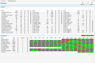

Hello Support,
I am using the 385mAh 3.8V Li-Polymer battery. The datasheet of battery is attached below. I am using Bq27z561 fuel gauge and the EV2400 for performing learning cycle.
Up to step 4 all the flags were set as per Technical Ref. Manual of the bq27z561 and QMax was updated. In the fifth step of discharging Ra table and update status was not changed. Also I have observed one unexpected behavior that the REST flag was just set after the full discharge occur. Even after the relax cycle, Update status was not changed.
Issue : - The Last discharging cycle error - Update Status is not change to 0x06
Could you guide me to overcome this issue?

  • No, I have checked the logs and rate was below C/5. Also there was one unexpected behavior that the REST flag was just set after the full discharge occur. and VOK was clear at that time.
  • I have again started the discharge cycle but this time The VOK bit is not set. FC bit was not clear. There was no change at starting of discharge.
  • It may help to collect logs and post it here for analysis.
  • I am sharing the logs of new learning cycle here.
    Here, at the first charging cycle I have calibrate the current. There was major difference in current. power supply shows 151 while Bqstudio shows 195.
    In the next step, Bqstudio sets the FD and REST flags while my battery was half discharged. First QMAX update was 329mAH. And Battery's design capacity is 385mAH.
    Again in this learning cycle Ra table was not updated.

  • I have setup the discharge rate c/5 in the first step. But now I got the same error in the first step. REST flag was just set after the full discharge occur.log_17_01.log
  • Hello Jainam,
    The root of the problem appears to be the wrong reading of current by the gauge. Was that corrected when you ran it again?
    If the REST flag was set immediately after discharge, then that usually means that the battery was discharged at a very low rate (normally <c/10).
    It looks like the terminate voltage is 3.0V for this battery. Can you send the GPCCHEM report for the cell. Or let me know the chemID of this cell if you did not use GPCCHEM.
  • This time current reading was accurate by the gauge.
    You can see in the logs, I have set the discharge rate between c/5 and c/6(72mA).
    Yes, I disconnects the load when battery voltage reach below 3V.

    Also, There was nothing connected  to the BQ27z561 EVKit still the Bq studio is showing the 3 and -3 mA current. That difference is continuously showing in the discharge and charge cycle too. Like if the discharging current is -67mA. But in logs you can see the -63mA and -70mA.
    Can you tell me what is this difference showing?
  • Hello Jainam,
    The gauge measures more accurately than 3mA, so there must be some other current. Disconnect load and charger from the gauge and see if you still see spurious 3mA currents.
  • Hello Shirish,
    I have tried all the cases, Remove the load and charger still I am getting the +3mA and -3mA current, Also I have cleaned the flux on the bq27z561 module(may me that causing the issue). But still getting the noise in current.
  • Hello Jainam,
    I suggest that you measure the voltage across the sense resistor and see if you see this same noise
