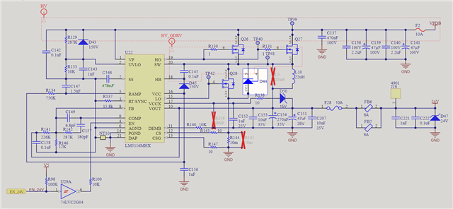

This converter has worked fine in the past (albeit, not optimally); however, these boards do have a component change. The converter schematic is shown below. D44 (NTS10120MFS), in parallel with the low-side synchronous switch, was changed to a new component with a slightly higher forward voltage drop: +0.2V (MBR15200DJF). Given this diode is not necessary, I am skeptical it is the cause of the problem.

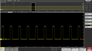

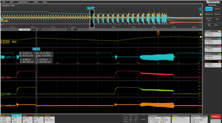

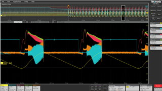

During testing, I found that the converter was hiccupping soon after the VCC voltage source was changed from the internal 7.4V LDO to VCCX.  At this point, VCC drops down to ~5V, and then decays more slowly over the next few switching cycles to 4.7V. This was only experienced when starting under a load above ~4.5A. The next image shows VCC falling during a hiccup cycle. Yellow is Vout, blue is VCC, and red is VCCX.

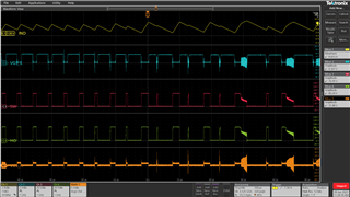

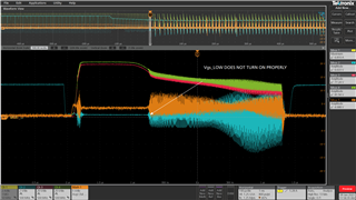

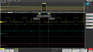

During this time, the Vgs of both low- and high-side switches also drop, causing poor enhancement of the FETs. In the image below, VCC is blue, high-side Vgs is orange, and the yellow and green signals are HO and SW, respectively. Please note, this poor turn-on is also seen on boards that start up under load and pass production testing. Furthermore, if a converter is able to ride out this period, VCCX increases, and the gates begin to operate normally. The margin between starting completely and not is clearly small.

    What's the FET part number? It's likely that the FET Miller plateau is close to 5V, so the VCC swing low during transition to VCCX results in inadequate turn-on of the FETs. The Miller plateau increases at cold, which is worst case for this potential issue.
    Tim
  • Hi Tim,
    The FET in question is a SIR632DP-T1-RE3. There are two of them on the high side. Based on the Vgs-Qg graph, it is approximately 4.5V.
    I did more testing after making the original post, including removing the VCCX function entirely. The converter will then start properly under load. This is an option moving forward, albeit with the increased power consumption not being less than ideal.

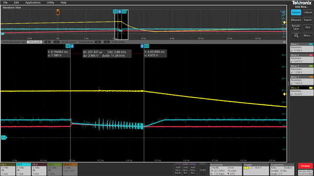

    The waveforms below are from a non-functioning converter with the new MBR15200 diode, loaded to 6A. CH1, CH2, CH3, and CH4, are the inductor current, Vgs_Low, switch node voltage, and HO, respectively. The Math function is Vgs_High.
    At t=-26µs, every-other high-side gate ON pulse begins to decrease. At t=29µs, the high-side switch does not turn off properly. The switch node voltage appears to decay faster than 150ns in the previous switching cycle.
    I reduced the load to 2.67A and repeated the measurements. Here, the converter will start up successfully, but the switches exhibit the same features.
    At this load, the inductor current becomes negative during the switching cycle.
    Reading the datasheet, it mentions wide and narrow pulses at the switch node being an indicator of sub-harmonic oscillation. Can this be a possible explanation for the alternating pulse widths seen just before the converter reaches this point?
