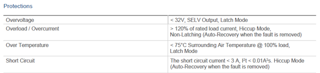

    The customer needs the OTP function for the latch mode in the ambient <75%. so we need the external circuit to make sure the function.
    So please help to check if the used SHDN can meet this function, thanks.
  • Hi Rock,
    1. Schematic looks fine. But one thing UVLO pin should also be connected through a resistor to VIN pin.
    2. If they need latch mode they can use below configuration :
    3.  Yes SHDN can be used to turn off device.
