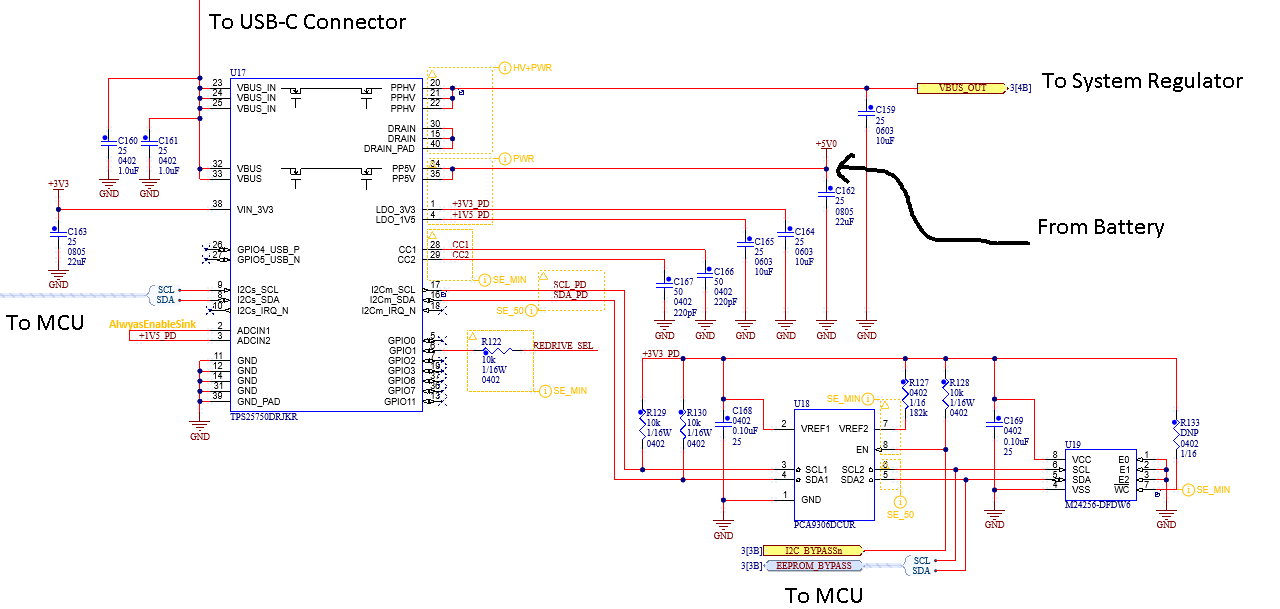

I have my circuit configured as indicated in the related question here: https://e2e.ti.com/support/power-management-group/power-management/f/power-management-forum/1130178/tps25750-charger-negotiation-voltage/4202856?tisearch=e2e-sitesearch. The only difference is I've configured ADCINx for AlwaysEnableSink.
There are situations when the dead battery flag is asserted and MODE=PTCH, but I am unable to load a patch or clear the dead battery flag.
Here's a register dump of the state I'm in, I highlighted the register fields of interest.

I'm not sure why the I2cEepromPresent is set to 0, since it is powered from LDO_3V3 which is regulated from VBUS_IN. But oh well here we are.
So when I try to execute the DBfg task, I get a "Task Rejected" return code. The MODE, INT_EVENT1, and BOOT_STATUS register contents are the same.
When I try to load a patch, After I write PBMs to the CMD1 register, I read it back and get a 0x40 byte with a NAK. Not sure what's going on.
I have attached the .json file I've used to generate the low region and full binary (and this is what is loaded on the EEPROM). I also attached the logic analyzer captures from the DBfg and PBMs tasks so you can see the raw i2c transactions.
Any thoughts on how I can clear the dead battery flag?

    I took a look at the schematic from the previous thread. Have the ADCIN resistors changed from that thread?
    It looks like you have a 422k pull up and 100k pull down in this case for both resistive divider . That corresponds to a decoded value of 3 and 3. In the data sheet this corresponds to the NegotiateHighVoltage dead battery configuration, which cannot be used when loading the FW from an EEPROM.
    I think changing the dead battery configuration to be in the AlwaysEnableSink configuration should hopefully solve this issue.

  • Hi Zack,
    Can you attach updated and populated schematic please.
    Very Respectfully,
    Brandon Beader
  • Thanks Zack,
    Because the device is being powered off of VBUS, it is not surprising that the Dead battery flag is being raised. Let us check internally to see if this should cause any issues with the boot loading sequence. It seems unlikely because the PD should be able to load a configuration from a dead battery condition.

  • Hi Zack,
    Apologies for the delay. I was able to speak with one of our engineers more familiar with the boot loading process and EEPROM.
    The dead battery flag being raised should not cause patch mode to fail.
    The device will get stuck in patch when the PD controller is not able to properly load a patch from and EEPROM or from a Host EC(Depending on what option you are using). The failure can happen for a couple reasons.
    This bit indicates that the EEPROM failed to load, and could be de-asserted for a couple reasons.
    1. Issues with EEPROM connection
      1. It appears that the EEPROM is working properly when internally powered(powered from Vin3V#, not from VBUS), so it does not seem like a hardware connection issue
    2. Invalid Patch (Patch fails verification)
      1. Similar to before, the patch (binary file on the EEPROM) worked properly when the device was internally powered.
    This indicates possible issues with the EEPROM and boot loading sequence.
    When I plug in the USB-C connector and there is an internal source already applied, the dead battery flag is not asserted and the system is functioning as expected (charger enumerates to 20V). However, when I remove internal power (i.e., unplug the battery), I can see my USB power meter/charger "reset" and it comes back up at 5V, with the TPS25750 dead battery flag asserted.
    I had a couple questions about your use case and your expected behavior.
    Is this the steps you are taking to achieve the current behavior?
    1. Device has internal battery connected and PD controller is powered.
    2. Connect an external device to the type-C port
      1. PD contract negotioated
    3. Remove internal battery
      1. PD controller reboots and gets stuck in patch
    If that is the case, can you try disconnecting and reconnecting the external device to allow the PD to power off, and see if it boots properly again?
    You could also try writing a "GAID" 4CC command to reset the PD controller.
    During the failing event, can you probe LDO 3V3 (primarily by the EEPROM) and see if it drops below the EEPROMs minimum VIN voltage?
    What is the power role for the two devices? Is the TI PD controller a source or a sink and is there a power role swap?
    Do you expect the PD controller to be in the same power role when the battery is disconnected vs. when it is connected?
    My current thought is that when the battery is removed, the PD controller must change the power source from Vin3V3 to VBUS, which is causing the PD to lose power temporarily and reset. During the reset, it attempts to load the patch again, but the EEPROM may not have enough power to be recognized properly.
    Thanks and Regards,
    Chris
  • GAID did the trick for me. I see there are some obscure macros in the TRM that mention GAID, but certainly no clear explanation of what it is or even that it is a 4CC command.
    To answer your questions:
    Disconnecting and reconnecting the external device to allow PD to power off - it still enumerates to 5V when reconnecting. The only way it enumerates to 20V is if it's powered internally and can read the EEPROM.
    Skipping the probing now, as I don't think this will add any value at the moment.
    It's configured as dual role PD with a preference of source. At least that's what's in the EEPROM (the .json for the configuration tool is attached in the original post).
    If the battery is disconnected, the controller should sink power from the USB port.
    I'm also thinking there's an issue when it switches from Vin3V3 to VBUS for power, but the fact that I can reset everything with GAID and have it re-read the EEPROM is what I was looking for in the first place.
