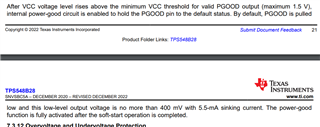

The status of the PGOOD pin is dependent on the voltage of VCC pin.
If the PGOOD pullup resistor connects to an external supply that is NOT connected to the VCC pin, the PGOOD will be High when en=0V.

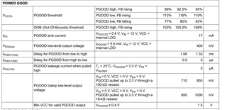

The EC table and description text states the VCC voltage needs be greater than 1.5V for a valid PGOOD signal.

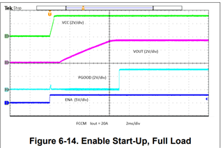

The oscilloscope waveform in the datasheet shows the PGOOD signal when using VCC pin as the pullup voltage source
