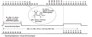

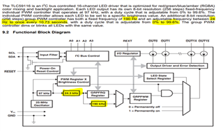

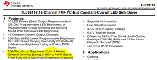

In the datasheet for this part it states that one of the PWM frequencies for global brightness control is 190Hz:

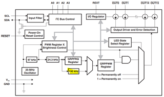

But, in the functional block diagram it shows 190kHz vs 190Hz as shown below.
Which one is the accurate frequency?
In addition, if this frequency is 190Hz it could be causing some EMI issues on our touch keys that are adjacent to the LEDs.  Can you please help me understand this part and if this PWM can be turned off while we still have capability to dim/intensify individual LEDs in serial instead of using the global brightness function. I would also like to understand the 24Hz adjustable frequency as well.
