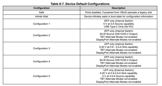

    Sortof, on boot, the TPS65987 first attempts to load a customers custom configuration from and external SPI or I2c digital interface. The configuration is a binary file generated by the customer using a GUI we provide, and is not there by default. When this fails, the Pd can load various default configurations, which can be changed by a resistive divider into the ADC_INx pins. This table list the different default configurations. Generally, customers will use the external options to load configurations.
    I would recommend reading section 8.4.1 of the datasheet for more information about default configurations.
