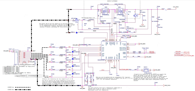

My customer wants to use BQ4050 in a new project.
And they are new to this device. they configure the BQSTUDIO under their understanding.
But they found the XCHG is always 1 ,
they use RESET command to reset the device, turn the FET_ON to 1, clear all the protection configuration but don't work.
here is their schematic and bqstudio expand file.
could you kindly check it and found out the root cause?

  • Hello Emma,
    Do you mean they set FET_EN = 1? The FET_EN allows the gauge to control the FETs so they won't be able to manually toggle them when FET_EN =1.
    Can you share a screenshot of their register dashboard with all the bits? They will need to make sure they have the gauge set to non-removeable if they don't use the PRES pin.
    Sincerely,
