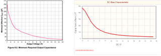

The minimum effective capacitance when used at 5Vout is about 60uF, but the capacitor used in EVM is only about 33uF.
Is it necessary to have a effective capacity of 60uF or more?

It looks like the 2x47uF capacitors on the evaluation board de-rate a bit more than the recommended minimum value. The user's guide for the evaluation board shows the load transient response with those capacitors and the response looks stable. See figure 3-4 here: https://www.ti.com/lit/ug/slvuby4a/slvuby4a.pdf
It looks like the evaluation board offers additional capacitor footprints to optimize the transient response if the application needs it. Perhaps the EVM design optimized solution size over very fast load transients and C7 and C8 were left unpopulated.
I would recommend following the datasheet curve, since it is more conservative design with more margin.
