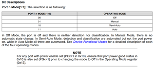

Hi Zhang,
Quick question to clarify, are you looking to have control over PPM features (Port Power Management) or something else within the PSE?
The TPS23861 has several operating modes to allow more control: auto, semi-auto,, and manual. You can find more information regarding each mode and their functionality in this document: https://www.ti.com/lit/an/slvaf77/slvaf77.pdf?ts=1673394837328&ref_url=https%253A%252F%252Fwww.ti.com%252Fproduct%252FTPS23861
Depending on which operating mode you're looking for, you'll need to configure the PSE 'Port n Mode' to the desired operation (page 58 of the datasheet):
