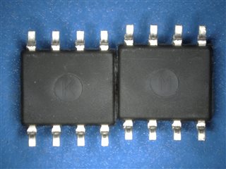

we recieved the parts with two differents markings in the same tube as the attached photos.
please advise?

  • Hi Andres,
    our customer has this enquiry,
    Qty of Cartons
    Pkg
    Count/Carton
    Date Code
    Lot
    COO
    1
    BOX
    855
    2214
    2093149EM2
    MY
    1
    BOX
    1330
    2212+5
    2082520EM2
    MY
  • Hi Henry,
    The marking in the bottom is an optional marking from manufacturers. However, I cannot give much info without knowing whether or not these were purchased from TI website.
