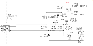

  • Hi Sir,
    Thank you for your reply, If I consider Vopto=15V, the Ropto is 3.162k
    the Gopto is -ve in db
    If gopt is -ve, is this okay for control design.
    Please suggest. as for the document, Gopto is +ve, give below for your quick reference
    Thanks in advance your support
    Thank you
    Umamaheswararao
    You need to get a +ve.
    There are several ways to do this.
    One is to have a Zener and reduce from 15V to a lower say 5 to 10V, then Vopto  is lower, so the resistor Ropto value will be lower. This should be easiest way.
    Second, is to use TL431 instead of TLV431, so the reference 2.5V instead of 1.24V since your Vout is higher so you can use TL431.
    Third is to find an optocoupler with CTR higher than 2 so to help +ve.
     Among these, if you use an Zener, then you will get +ve quite right away.
  • Hi Sir,
    Thank you for your reply. I will the zenor and TL431 to make the positive gain.
    As per my understanding from above circuit, R13 is current limiting resistor for the zener,  Ropto is R15. What is R14?
    If Vopto = 9.5 (minimum voltage of Zener)
    VF =  1.3V
    Vsc (TL431 minimum) = 2.45V
    I_TL431 = 1.3mA
    R_opto/R15 = 1459 Ohms  (Please confirm is this correct?)
    This value is different in the above referred circuit. If I consider, 3.6mA then R15 is 499 Ohms. If I consider 3.6mA based on CTR ratio, the refelected current on the transistor side of the optocoupler is more.

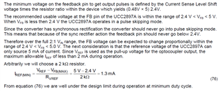

    As per the controller IC (UCC2894D), V_ref max is 2mA
    In the application note, R_ref is calculated based on maximum current drawn from the Vref pin. For quick reference same is given below
    From the above screenshot, I am not understanding the following line "The minimum voltage on the feedback pin to get output pulses is defined by the Current Sense Level Shift voltage times the resistor ratio within the device which yields (0.48V × 5) 2.4V."
    For UCC2894D, the CS pin voltage is 1.27v, from this if I calculate the minimum voltage at the feedback pin to get the output pulses is 6.35 (1.27*5)
    V_ref is 5V
    V_fb_max is 6.35
    I_ref_min is -Ve
    Is ths corrrect?
    Please suggest how to calculate the R_ref for UCC2894D as well.
    Thanks in advance for your support.
    Umamaheswararao
    R14 is to set up a bias to opto coupler so opto coupler is not in fully cut off.
    R_ref should be 2k and always like this based on many designs. other values cannot make the IC work properly.
    UCC2894 FB voltage range to have switching pulses is between 1.25V and 4.5V so different from UCC2897A.
    Note (0.48V x 5) = 2.4V, so the equal symbol missing.
    I_TL431 usually consider about 1 mA in a design as best option from many designs. You adjust other parameter values to achieve proper design but keep the above as default and usually no need to redesign as these proved close to best.

    1. If take R_ref is 2k, waht will be the minimum voltage at FB pin? What is resistor ratio for UCC2894D (it is mentioned that 5 is the resistor ratio is 5 in UCC2897A application note)
    2. if I consider I_TL431 is 1mA, R_opto is 1.897k, Please confirm the same and Can I take R14 and R15 same?
    3.  "You adjust other parameter values to achieve proper design but keep the above as default and usually no need to redesign as these proved close to best."  from this line, as per my understanding, i have to redesign the R14, R15, R_ref and the remaining all parameters can be same, please confirm.
    Umamaheswararao
    1. R_ref is connected to VREF (=5V), so to make FB = 1.25V, the I_ref = (5V-1.25V) / 2k = 1.875mA, so you need to design your opto able to sink 1.875mA, or roughly 2mA, then FB can reach 1.25V. UCC2894 structure is slightly different and please refer to page 6 diagram of its datasheet.
    2. R14 should be about 0.5 to 1k for most of the opto coupler. R15 is your Ropto which value needs to design and follow the application note.
    3. R14 is about 0.5 to 1k, you can keep 499-ohm, the remaining needs to design to check if they are ok, for example, +ve is required and if you get -ve you have to adjust your design to achieve +ve.

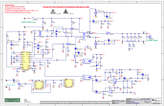

  • Hi Sir,
    As you suggested, UCC2897A can be used only for p channel FET. But, as per the below document, UCC2897A can be used for high side clamping with N channel FET. Please confirm the same
    Please suggest the best one.
    Thanks and Regards
    Umamaheswararao
    If you add external inverting driving transformer, ucc2897a is ok to use for n mosfet.
    in general, for vin > 100v, we recommend ucc2894 with n fet clamping.
    some designs like use ucc2897a with external driving transformer with n fet because the designs want to go with lower cs threshold.
    besides, ucc2897a VIN pin cannot be used when vin > 100v.
    in your design, I still recommend ucc2894, but if you want you can use ucc2897a if you think it’s cs threshold is better, which usually reduces power losses but more likely affected by noise in high vin applications.

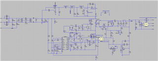

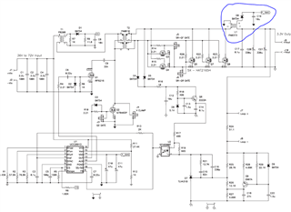

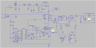

  • Hi sir,
    Please check the modified circuit as per your suggestion.
    Please suggest if required any modifications in
    1. Bias circuit
    2. Driver circuit
    3. Compensator
    4. EMI filter
    Thank you
    Umamaheswararao
    As this is to review the schematics, it requires time. I will reply to you in about one week.
    1) Note 12V Bias needs to reach 13.2V in order to start up UCC2894.
    2)
    3)
    4) Do you think you also need to have a differential choke in your EMI filter?
  • Hi Sir,
    Thank you for the suggestion, I will change the Zennor diode (witch is connected to the series regulator directly connected to the Vdc input) to 13.2V to get the initial voltage.
    I dont have any idea about EMI filter, Please suggest.
    Please suggest if any further modifications are required.
    Thank you
    Umamaheswararao
    I suggest to add a place holder for differential mode choke. In most cases, a differential mode choke is needed. In the best case, you can just leave that place holder unpopulated.
    If you have no idea how to design EMI filter, I would suggest you first to look into anybody within your team or group with such expertise. EMI is kind of tricky and usually not easy to handle if without any experience or without any expertise nearby when you want to pass EMI test.
    There are many literatures on EMI. So you may need to review these to gain knowledge.

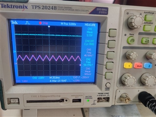

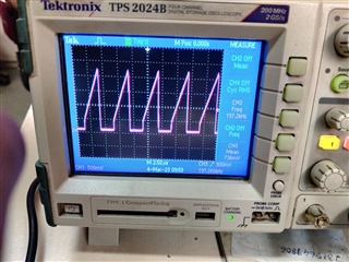

    Thank you for the reply. I have connected all the external components as per the datasheet
    for the testing, following values are used
    RDEL = 10k, RTON = 71k, RTOFF = 150k, CVref = 0.1uF, CF =  0.1uF (no RF connection), Rslope = 47k, Css = 0.1uF, CHF = 0.22uF, Vin =59V, RIN1 = 141k, RIN2 = 3.9k, RIN3 = 141k, RIN4 = 2.7k, Rvref = 2k,
    Vdd is given using external power supply (set to 13.2V at the starting and thereafter maintained to 12V)
    Vref alos given using external power supply (2.2V)
    Observations:
    1. At Rslope pin, 196kHz waveform is generated  (pin number 8)
    2. Vref = 5.1V generated  (pin number 4)
    3. 0.95V is obtained at SS/SD pin (pin number 10)
    4. LineUV= 1.31V generated  (pin number 15)
    5. LineOV= 0.95V generated  (pin number 16)
    6. No pulses at Pin 12 and 13 (OUT and AUX)
    As you mentioned SS pin voltage becomes 0 to 5V, but it is not happing. Please suggest if any modifications are required in the circuit or components design.
    Thank you
    Umamaheswararao
    Please provide the waveform of CS, SS, FB and OUT.

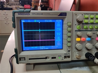

    Sorry for the late reply. As per your suggestion, I have applied 14V at Vdd and the corresponding waveforms are as follows
    1. FB and OUT
    2. OUT
    3.Vref and SS/SD
    4. RSLOPE
    5. CS and OUT
    Voltage at SS pin is below 1V and no OUT signal. Please suggest,
    Umamaheswararao
    The SS needs rise up to 5V and stays there to work.
    First check the capacitor value and connection on SS to make sure ok.
    Then capture waveforms SS with the below:
    Vdd, LineUV, LineOV, Vref
    and provide these waveforms for analysis
    Thank you for your inputs. I have increased the VDD capacitance to 220uF, Now, SS pin charged to 5V and at OUT pin pules are OK and varying duty ration with Vfb.
